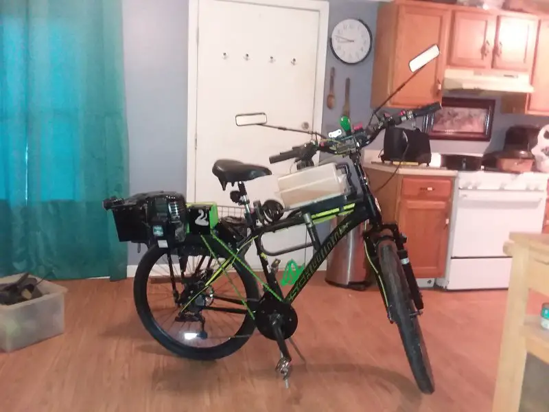

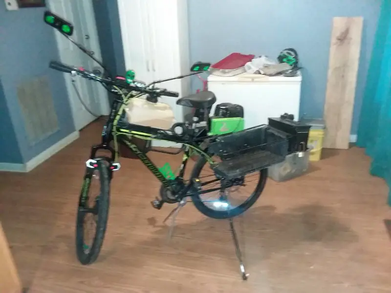

I've had my Robin Subaru 35 which is a 33cc 4 stroke for 11 years now. It was very easy to install since it's a rear rack mount. I also run through a triple chainring shift kit; the reduction range is 66.79:1 to 16.25:1. This enables me to do with a small cc engine what most larger cc engines can do. I also use a reduction gear box instead of a reduction belt drive.

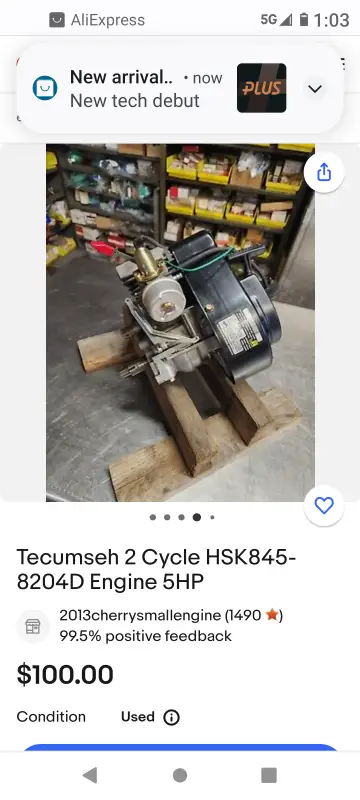

Old 2 stroke and new 2 stroke... My 74 40hp Evenrude outboard motor has the same engine as a 75hp the difference is the exaust and another carburetor... My artic cat from 74 was the same deal... In the mid 80's they peaked... By the 90's there was pressure from the EPA to replace them with 4 stroke engines... Gas to diesel in the big boats... 2 stokes went from 20:1 premix to 50:1 for the EPA... The 4 stroke got better to replace the 2strokes with counter weights to smooth them out over head cams to be powerful as 2 stroke... While this is going on outdoor power equipment barely changed... EPA didn't effect them off road engines... Plus it's a harder sell for heavier less powerful hand held engines... These 2 stroke engines for bicycles are copy's of the 1940's design and the 4 stroke engines only just got over head valves... So it's not a comparison to today's on road or EPA engines... They still require the old gas ratios and carburetors and like time stood still... The big difference is in the wide pedals to clear the 4 stroke... The 2's are made to fit a bicycle with no modifications just bolt it on... Rear sprockets all you have to change... A 4 has gear reduction or CVT belt... A 4 has less RPM range but makes more torque than a 2... More custom fabrication etc... It really depends on how you ride... And you're fabrication skills... And also how much space you have to work on and store your bike... Long distance go with a 4 if it's short distance a 2 is going to be better... Not a lot of money skills and space a 2 stroke is going to be for u... You can start out with a 2T kit and switch to a 4T later but if you modified everything for a 4T it's going to be difficult to go back to a 2t setup... Another example is the 2 stroke Tecumseh engine... It's 2 stroke but everything is going to build like a 4 is configured... Or the shifter and friction drive engines 2 or 4 stroke are set up completely different than either of those type engines... The China Happy Time is my choice because it's the cheapest and easiest build and I don't have a long distance to go... It's more of an ongoing never ending art project than something I would ever depend on...
