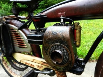

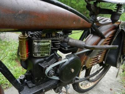

Its the small drive pulley thats slipping. Once I go to the notched belt and a slightly taller pulley it should be good. Thanks for all the encouragement Guys.
I actually have it on kind of a sliding rail so as you apply pressure the jackshaft pulley slides backwards applying pressure evenly between the front and rear belts and pulleys. I was using a Whizzer manual clutch but I didn't like the look of the offset pulley or how it was constantly engaged until you pulled the clutch so I made it so the clutch was inline with the drive pulley and the rear sheave, and its disengaged until you engage the drive. Just seemed safer to me.....the idea that a broken clutch cable would result in it being stuck in drive just seemed like a poor idea.

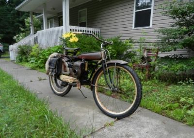

Talk about patina... it looks like you found your grandpa's motorbike out in the loft of his barn and with just a little fussing... air in the tires and some gas in the tank, some high hopes... and it coughed to life with a putt putt putt. And off you ride into the sunset in the shadow of your imaginary grandpa. A grand illusion you have created and done yourself proud, sir.
SB
AWESOME!
realy like the old barn find look, just like back in the 50's when all we had was the old Briggs for motors. What is the diamitor of the front pulleys?..............Curt
Thanks Guys, I'm really happy with the way it turned out. Took it recently to a Antique motorcycle show. Had a ball just standing off to the side and listening to people speculate as to what it was. Ironically it just happened to have the perfect backdrop. Curt the front pulley is a 1 3/4".

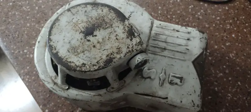

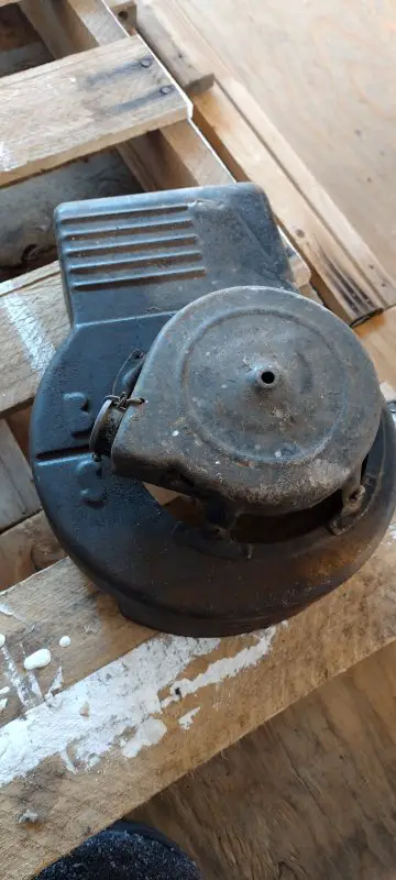

For a 79cc predator walking up some '50s shrouds :cool:
