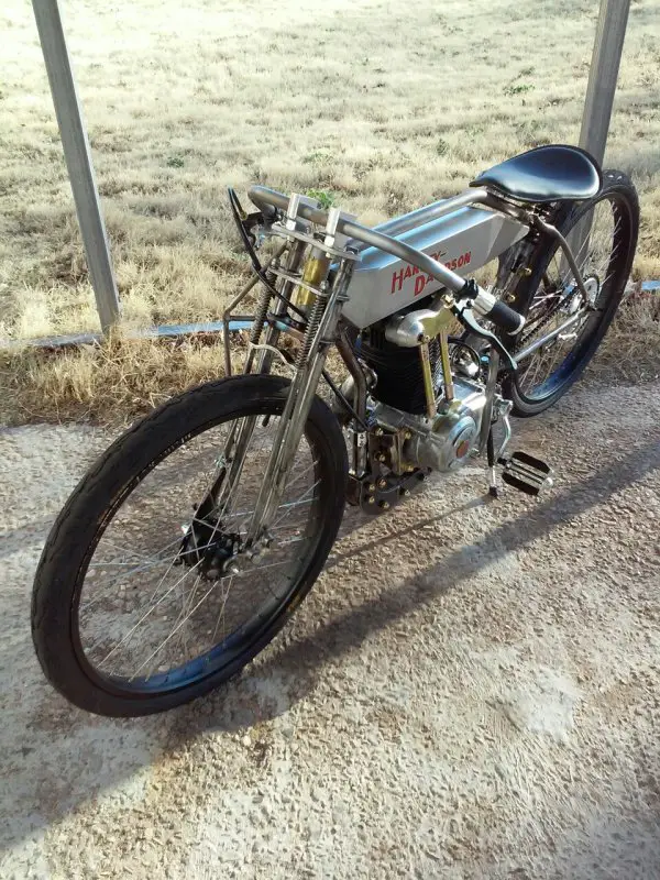

Hello all,
I just installed the predator and I am having mixed feelings about the look. I will be going with another engine choice. Attached are a few engine choices, your feedback would be appreciated.
By the way, the Predator setup was fun and very fast. The brakes needs a serious upgrade.

Just a couple of observations Marc. The 5 hp Miller engine will take on a totally different personality once the cooling shroud and fuel tank are removed. A relatively smooth billet flywheel is a great investment in performance, safety & appearance. A look at Jeff's beautiful motor verify's and starting with a heavy duty cordless electric drill is easy...save the shoulder by elimination & clutter of the pull type recoil starter mechanism.
Though the rear drum is hidden I'm guessing it's a Sturmey Archer drum hub, laced to a 36 spoke bicycle wheel. It should be easy to buy a matching front wheel with a SA drum hub to match the rear. I used that front setup on a Simplex dual spring fork for my Harley Davidson Pea shooter build & it worked out great. It stops the HD well & looks great, though bicycle disc caliper & rotor stop quicker you do loose a bit of vintage look with that setup. I'll post a photo latter of the SA drum brake on Simplex forks.
I really like the stance your Simplex presents, very clean. Rick C
