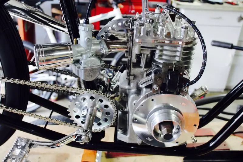

A lot of the Simlex guys and gals at Portland put V twins Vanguards. Harbor Frieght carries a v twin now. Pm sent
Velodrome
May 27, 2011
2,387
271
Phoenix-ish
Im in love with that Gravley but Wolf's suggestion in post #14 would be a much more doable and meet your speed / torque goals. Hey CCC where you get those Raptors? Can you get em pre built or do you have to piece and part them togather on your own?
