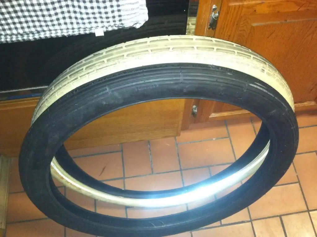

Impressions, They are definitely going to last a long long time, probably never get flat, and are super stiff. They are HARD to install. H-A-R-D!!! I broke 3 bicycle plastic tire irons putting them on. I ended up using a couple of giant screwdrivers. Go to a motorcycle shop and get real metal motorcycle tire irons to put these on. They are never going to fly off accidentally Lol. They fit the rim perfect, just tight and secure, the way a 92mph rated tire should. Oh, use liberal amounts of Windex to use as lube to help slid on. I like them. I feel safe.
It feels more stable than the bicycle tires. Also a lot less to worry about. They are slightly narrower than the Fat Franks, so clearance is not an issue. I like them. I thought that losing the white rubber would be a negative but it's fine. Looks different but still looks good.

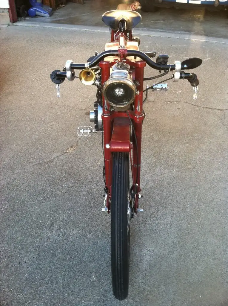

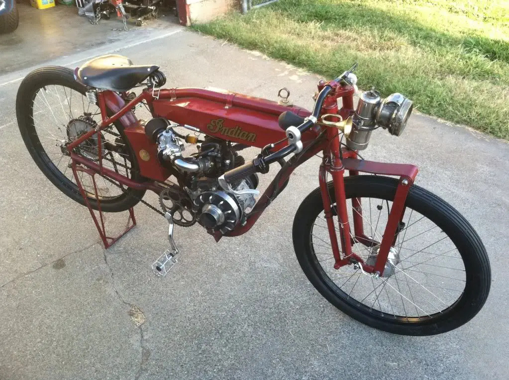

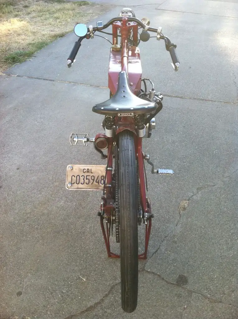

Good eye Harry. I wrote him a note to ask him about this. Probably wanted white tires at an economical cost. The one where he has the Simplex Servicycle tire on the rear is probably for longevity in the race/ride. I got almost 2k on my front Fat Frank and it could have gone farther, but the rear tire life is really bad. The rubber is far too soft for motorized use. But the Fat Frank LOOKS good! Lol.
Yeah thats a beautiful bike..... so you think thats a Simplex tyre on the rear? If so you can really see the difference in size between the Simplex and Fat Franks.
The Fat Franks are a nice looking tyre but im digging the Simplex tyres on your bike, and they obviously perform better..... and i know you said you were going to paint your new wheels red, i cant wait to see that. I reckon its going to make your bike look even better.... if thats even possible.

The most apparent improvement in the Simplex tires is the lack of side roll on the rims. With the Franks I didnt like the bounce from side wall roll. With the Simplex I can dive bomb corners like it was on rails. Very confidance inspiring.
I got it up to 50mph. That is about what my bravery can stand right now. When I have the new strong Worksman wheels and big front and rear heavy duty brakes I'll try faster.
