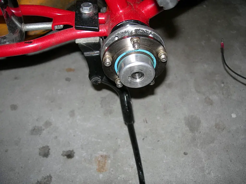

I have decided that the 4th version of the Red Hornet would be my trusty old HS mated to an internally geared Shimano Nexus hub. Since motorized bicycle engines are left hand drive and hubs are right hand drive, I need a jackshaft to transfer power. The HS engine mount that comes with kits is large and bulky and would interfere with the drive line for my left hand chain, so I fabricated this engine mount which is open in the rear and provides a clear drive line for the primary drive chain. It's made from one piece of 1" x 1/2" x 5.5" steel welded to a steel plate drilled to match the mounting holes on the bottom of the HS case. Each end of the mount is drilled and tapped so a bolt can be used to connect the mount to Kuryakyn-type clamps. The mount is very solid and simplifies installation of the engine. I am currently making the jackshaft from two 5/8" pillow block bearings and a 10" x 5/8" threaded and keyed shaft. The jackshaft will be mounted to the downpost using a large aluminum CB antennae mount. I will post photos as the project progresses. I'm hoping the HS and 3 or 4-speed hub will make the bike more practical with good take off and resonable top end. I also have a Sram Automatix 2-speed hub that I might lace up for the project if I can figure out how to purchase Cesur's disc brake adapter. The automatic would be legal, the 4 speed would not be.

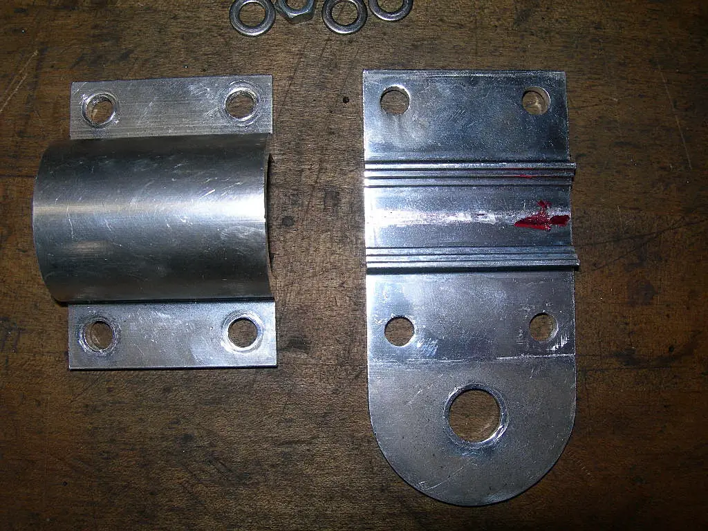

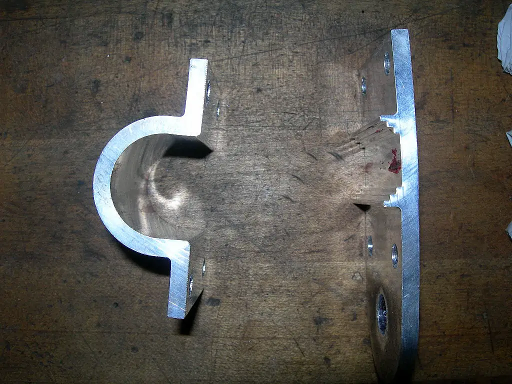

In cases where a hinged clamp won't work, you can use a trucker's antenne mount. It's made from aluminum and comes in two halves that are held together with 4 bolts. It's actually a little more substantial than the Kuryakyn clamp and it has a flat surface for mounting things like jack shafts or tensioners. You can get them at truck stops for $20 apiece. I have used them for engine mounts as well.

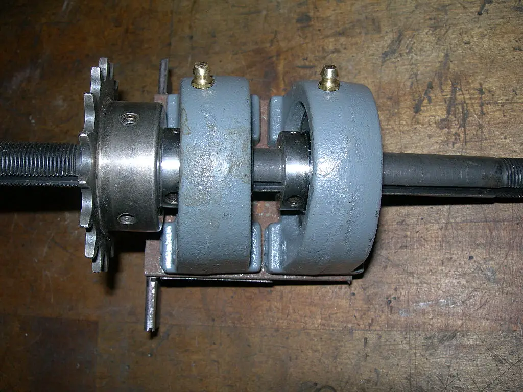

Here is the next step in this project. I fabricated a jackshaft from two 5/8" self-aligning pillow block bearings, with zerk fitting for lubrication, and a 5/8" fully keyed shaft. The mount was made from 1/4" x 3" flat steel and a piece of angle iron from my scrap bin. The jackshaft will mount below the custom engine mount and will pivot so I can adjust the chain. The final drive sprocket will connect to a dual sprocket freewheel mounted to the pedal shaft. I don't have the rive sprocket on the shaft yet. The problem with a project like this is it takes so much time to get the angles and measurements just right. The next step is to actually mount the jackshaft to the motor mount. Pictures to follow,, stay tuned.

I was in the workshop again today fabricating the next step in my custom engine mount. The Jackshaft mounts beneath the engine mount in the "V" of the frame so it's out of the way. The mounting bolt on the left is in a threaded hole and when loosened allows the jackshaft mount to swing up or down a few degrees for chain adjustment. The nut on the right tightens the mount over the adjustment slot to hold it in adjustment. I will need to purchase a 9 or 10 tooth sprocket for the primary drive and another 9 or 10 for the secondary. The secondary sprocket will be connected to a dual sprocket freewheel on the pedal shaft. The second sprocket will drive the final drive sprocket on the rear wheel. The jackshaft is heavy duty and would probably be better with lighter pillow blocks. Mine are 1 1/2" wide, 1" would be better for the overall width of the unit. The good news is they will outlast the bike and the engine.
