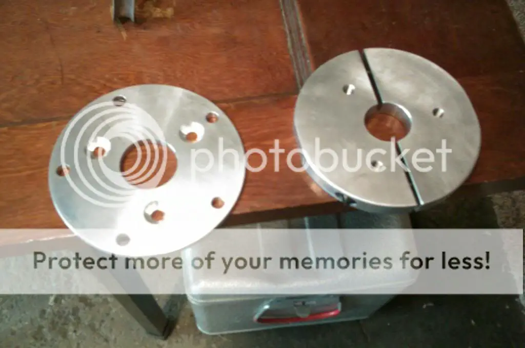

I machined a couple pieces 6" diameter. The piece on the left is going on the outside of the wheel and the sprocket will bolt to it... the piece on the right will clamp around the hub.

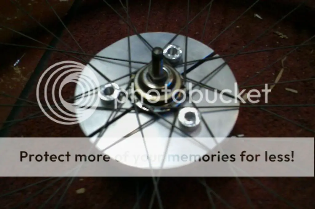

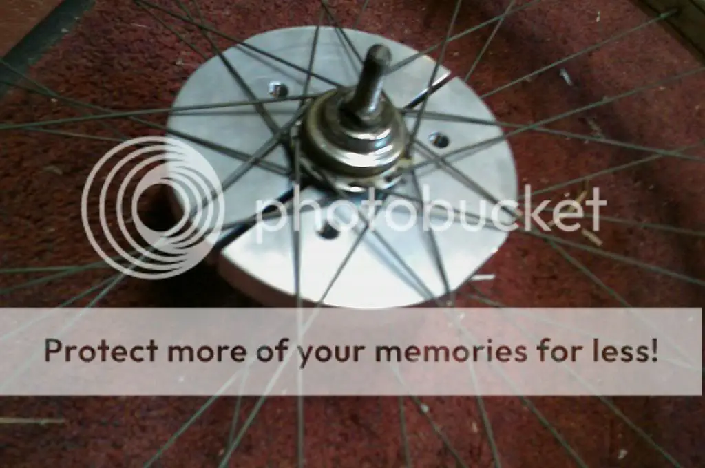

Here's the piece clamped around the hub...

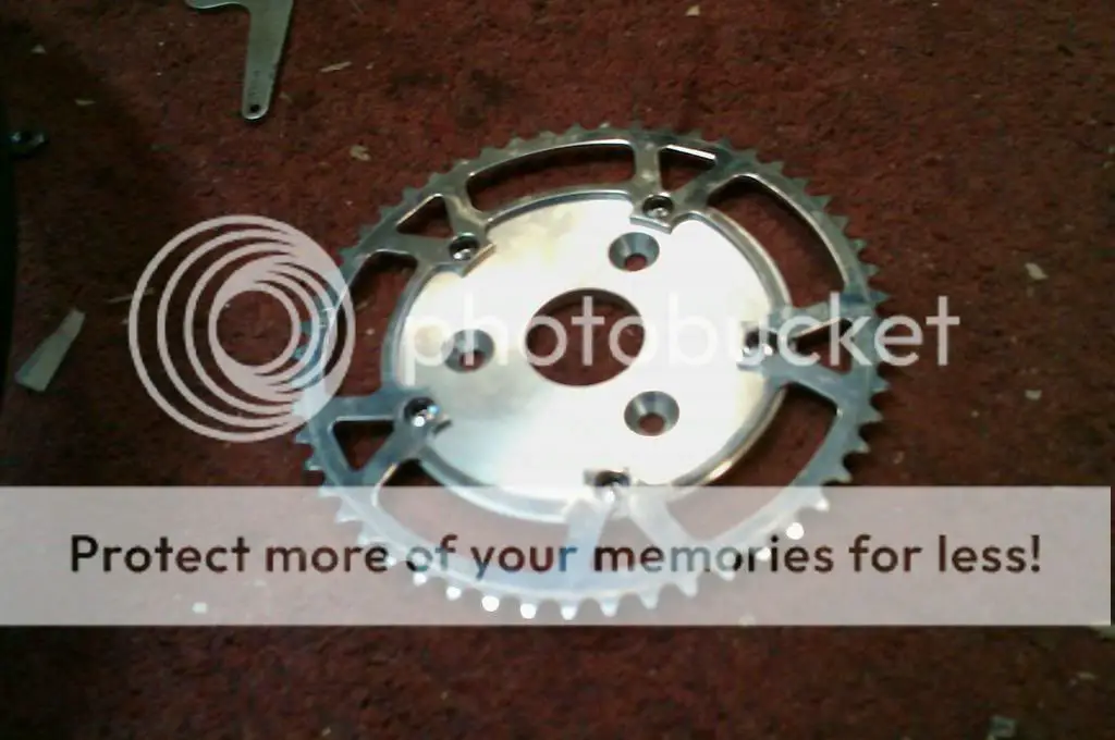

Here I bolted a standard 130mm single speed / BMX chainring onto the other piece... I ended up re-bolting it onto the backside eventually to get a proper chain line

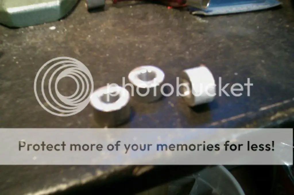

Then I made some spacers to sandwich between the two pieces...

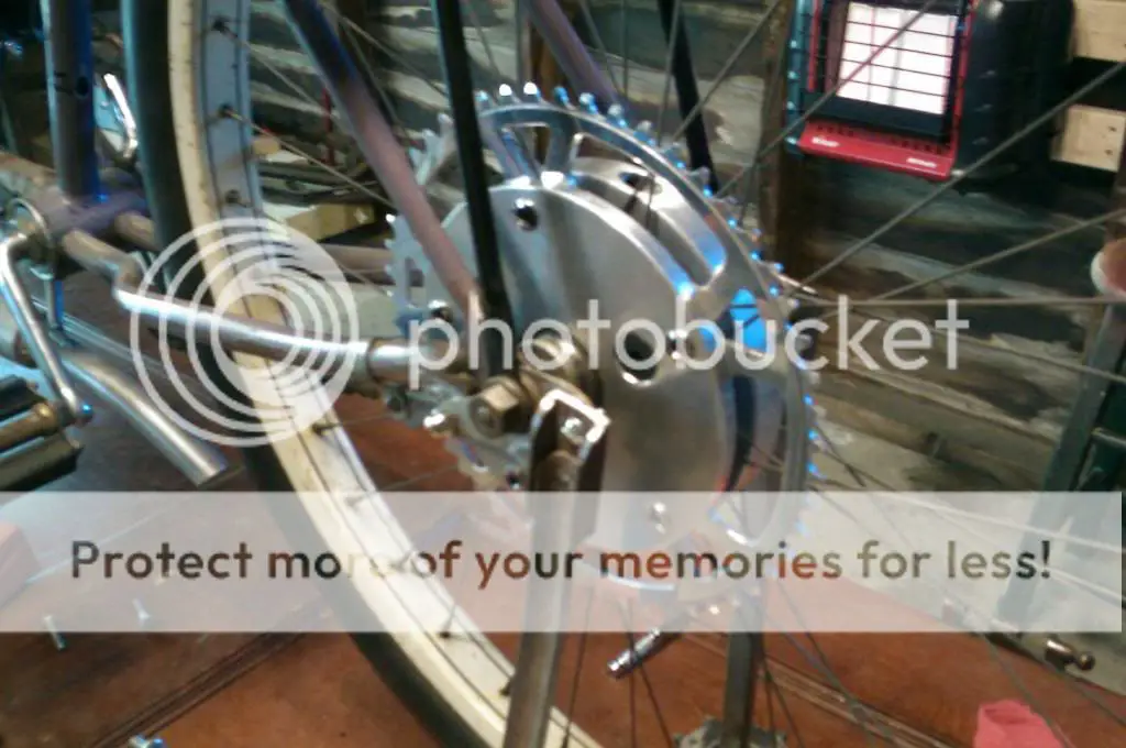

And here it is all put together with the brake arm back in place...
And here it is on the bike... everything worked out great... runs straight and true and one step closer to gettin' er done :)

Greg58, I chose to use a 53t sprocket... it's pretty large. It's definately the largest one I plan on using. The nice thing about this set-up is the fact that I can quickly change chainrings without too much effort... and I'm gonna fabricate an adjustable position chain tensioner so I can use anything from my 53t down to... ummm... maybe a 39t...??? maybe... not sure yet... still workin' on it...lol :)

I finally got it all put together and running and have a few miles put on...16 to be exact.
Just wanted everyone know how this 53 rear sprocket is working out... it's pretty sweet!
It's such a low gear that I can actually take off from a dead stop pretty easily with out any pedal assist... although I'm only 5'6" 145lbs so, it's hauling a little less weight than your average guy.
I'm using an old stewart warner bicycle speedometer and she seems to be bouncing between 25 and 30 mph when the rpms get up there... but not screamin'.
The motor is still breaking in and I'm not pushing it very hard so I'm pretty happy with the top end so far.... probably wont go much over 30 with this gear, but it does accelerate nicely... pulls better than I expected :)

This looks like a pretty nice design! How thick is the piece that clamps around the hub? I see bolts going through the inside piece too making this NOT a rag joint but a more versatile sprocket adapter similar to the pirate cycles one.
The concept is exactly the same as any clamp on style. It puts no more stress on the spokes that any of the well known types. It relys on the clamping action on the hub.
Look at the design again, Caleb, and I think you'll agree. Yes, there is the potential for spoke damage, as there is with any clamp on adapter or rag joint if excessive slippage occurs. But that's the idea. It's not supposed to slip. As long as there is sufficient surface contact area at the hub, it shouldn't.
Yeah, I'm glad you guys get it. WightBoy, the piece that clamps around the hub is .625" ... if I were to go any wider it would have hit the oiler in the center of the hub... if someone wanted to go thicker, they would have to notch out a spot for that... it's do-able... I just dont think it needs to be any wider... so far it's holding great! We all know that more clamping surface is better... but in this case I'm counting on the fact that I machined this part to be within .002" of the hub diameter... it's a solid precision piece that almost snapped around the hub... then you torque down the clamping bolts and it's rock solid.
