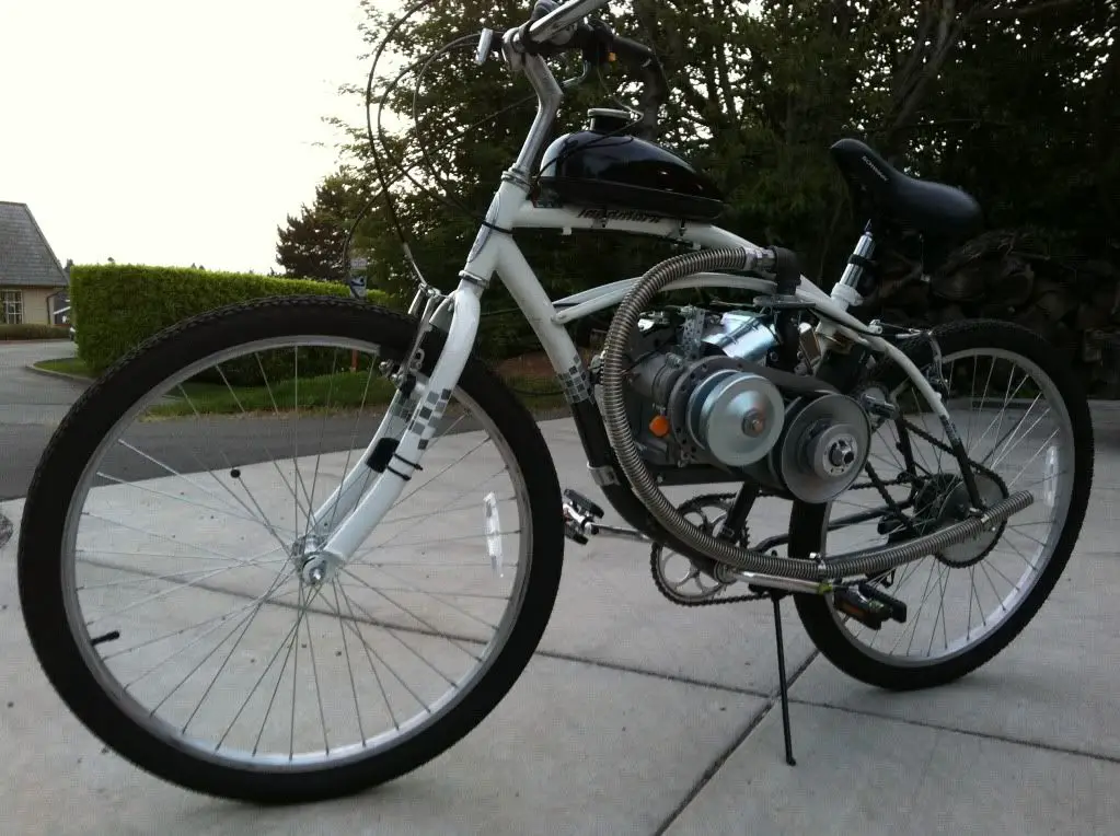

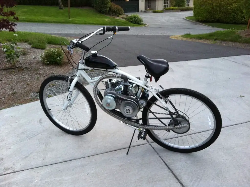

Hello,
Just wanted to rejoice that my latest build of a 99cc predator engine coupled with a TAV2 CVT is finally done. Took lots of research and time, but the efforts have payed off!
http://motorbicycling.com/showthread.php?t=39355

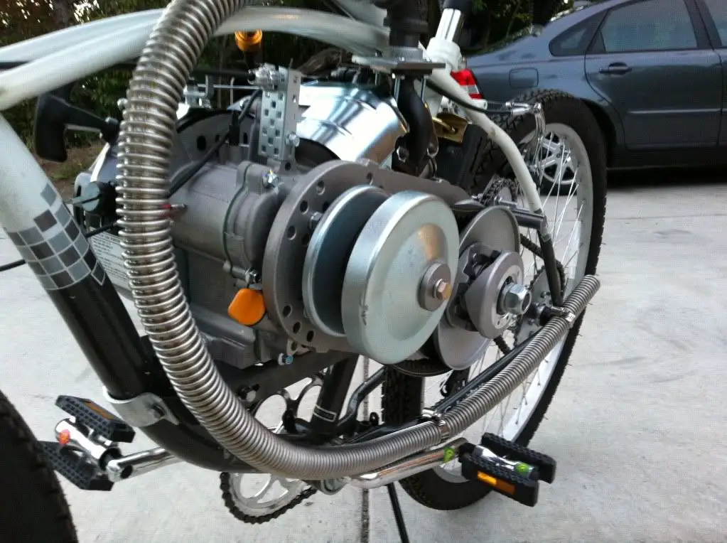

That is one awesome beast. Give us a few details on how you fit that exhaust together.

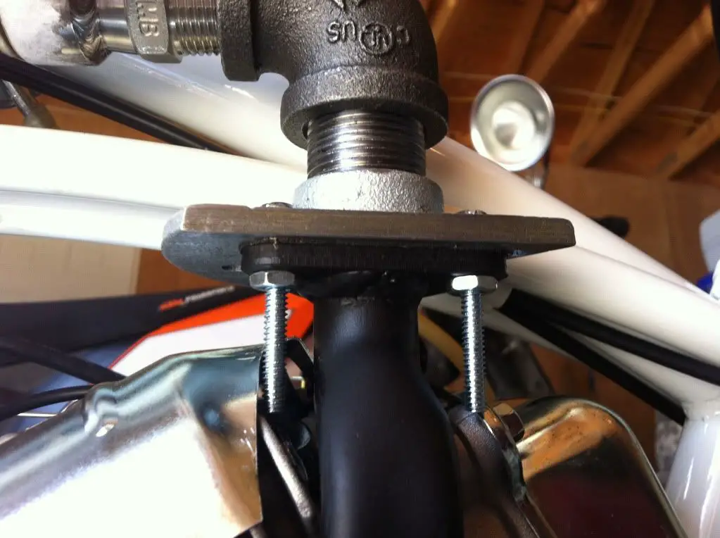

I made the exhaust setup by first aquiring a 3/4" flange pipe adapter from lowes/homedepot, sanding it down a bit on the bottom and smoothening it out for a tight seal, cutting off excess sections of it, and then drilling holes to match up with the triangle exhaust manifold that comes stock on the predator.
Everything else is just some steel pipe fittings that the flex hose threads into.

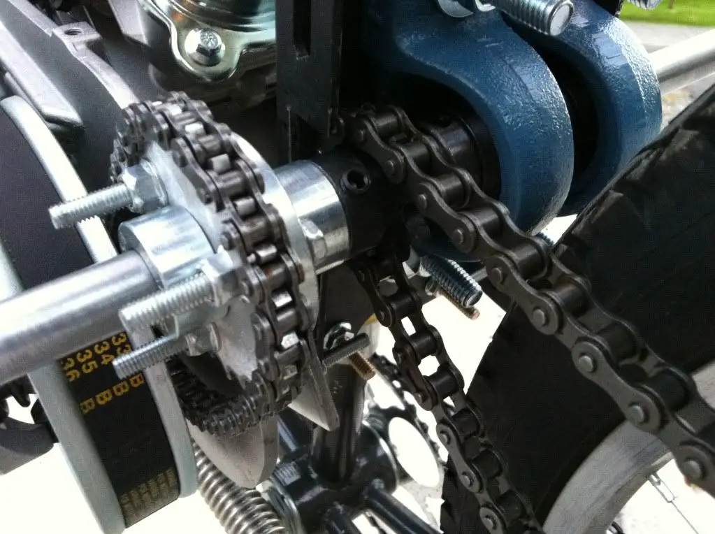

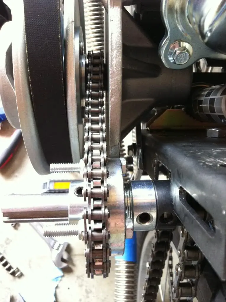

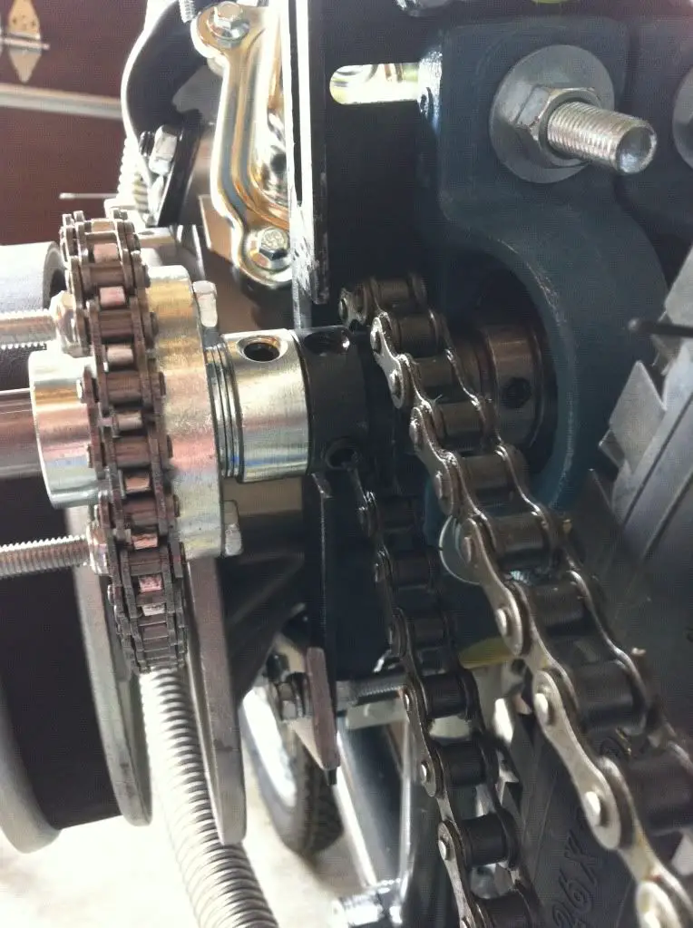

The driven sprocket assembly on the jack shaft reminds me of the axle mounted shredder on one of the cars in the movie "Grease".
Ya, those bolts are a bit too long, but it's what I had at the moment haha!
Click for photo
I was thinking meat grinder with the long bolts and exsposed pulleys of the cvt.. Friction burns and leg hamburger meat I hope are not the plans on this well done ride!!
Luckily I have a cover for the CVT, already trimmed the bolts down, and plan to cover the jackshaft sprocket. No leg hamburgers PLEASE!

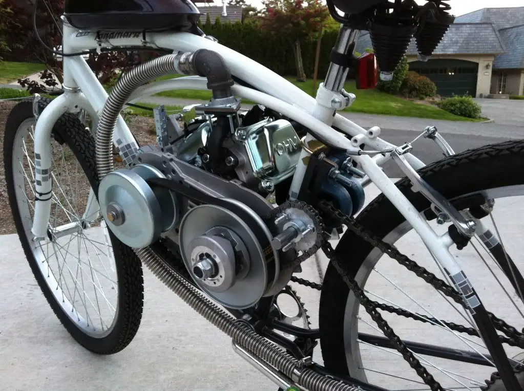

On a happy note, I took it for a very very short ride, and the acceleration is just amazing! Significantly better than the 99cc predator build I previously did with AGK's single speed jackshaft. I have not taken it up to speed yet over 20 mph though, as I'm still scared of that jackshaft gear. And boy, that belt drive is sure smooth in it's engagement compared to the vibratey/shakey centrifugal clutch.
Well, today I receive my #35 offset link in the mail to tighten up the chain that links the CVT to the jackshaft. As soon as that is in place, I get to finally take it out for a full speed run!

Do you have a top engine mount?
I have one on mine, helped with vibes and frame flexing from drivetrain torque, since my jackshaft is mounted on the engine.

Top mount might help. Lot of room for harmonic vibration with all that overhung oscilating parts engine weight.
I used a u-clamp around the front tube and a modified ragjoint plate and a short allthread, connected to the front gastank mount stub.

Here is an upper bracket I made for my 212cc Pred. out of 6061 T6 aluminum and a u-bolt. It clamps to the down tube and keeps the engine mounted solid. It was a nice place to mount the fuel pump as well.
