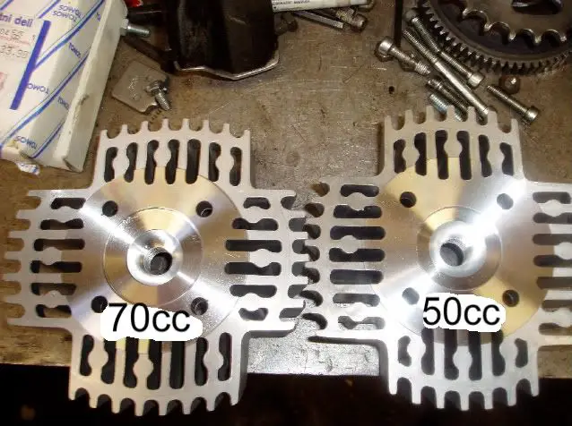

Maurtis...pull the trigger and purchase the 50cc puch head. Yes I said 50cc. It helps with performance, it's inexpensive and it looks good.
On my two applications I just enlarged the stud holes which I don't think you will need to do since you have the smaller studs. I run one head gasket and 100 octane gas, if you can't find the gas purchase some octane booster and add to your mixture.

Saw this posted over on MopedArmy and thought it was an interesting side-by-side of the Puch high compression heads:

Here is my 66cc engine with a 70cc Puch cylinder head and it works great white a Squish of 1.8 mm! Becomes just right compression for the engine
