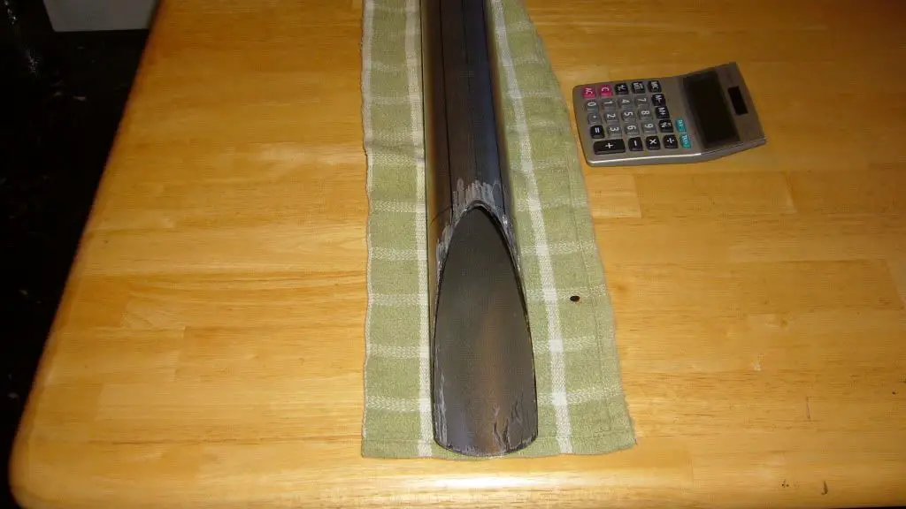

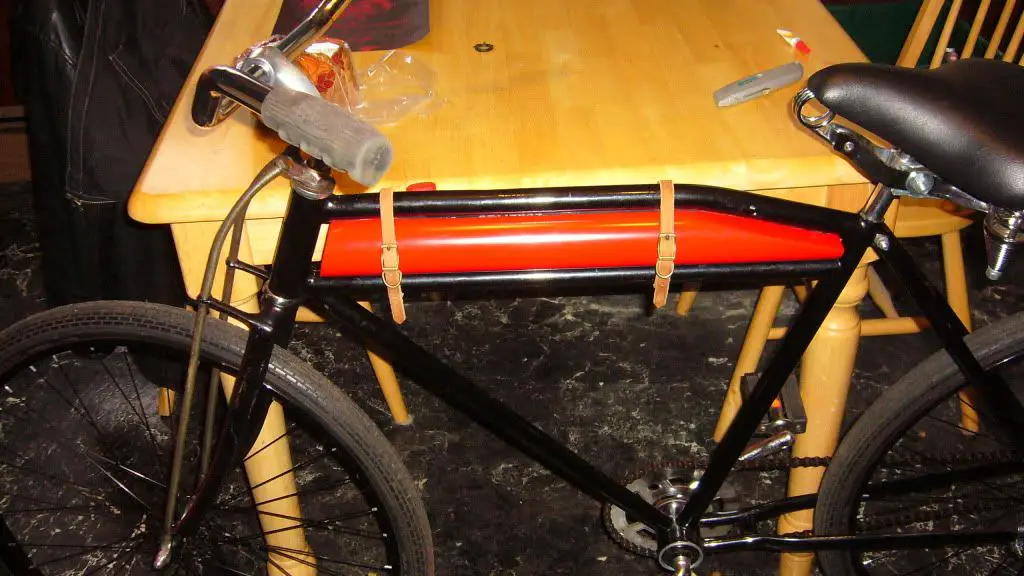

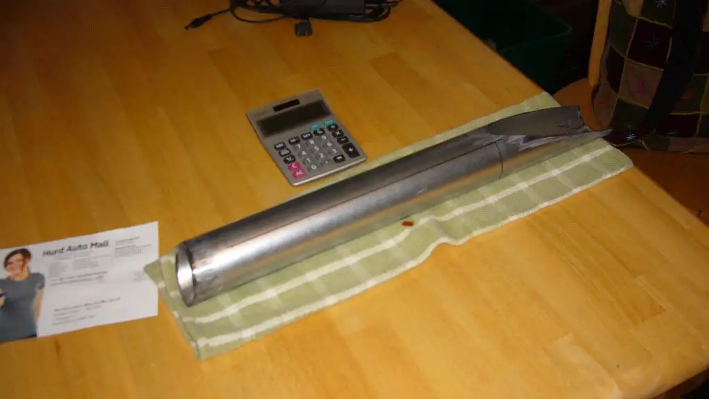

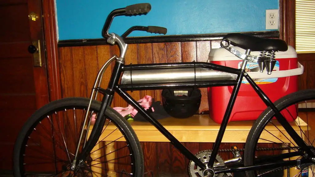

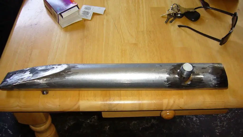

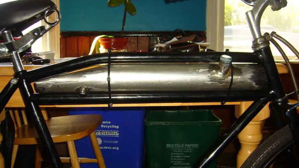

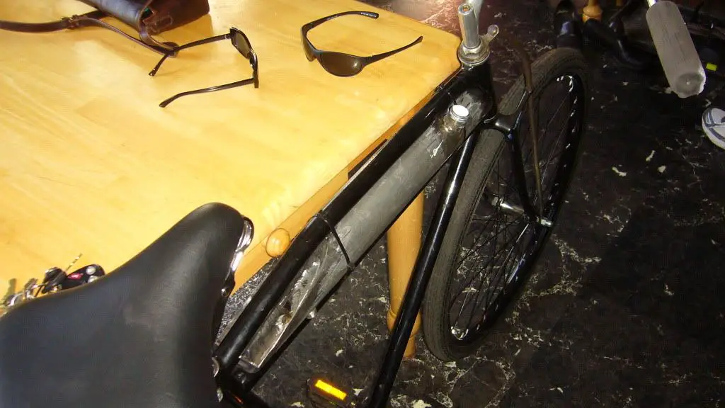

I decided to finally get to work on my first round tank.
I started with some mild steel tube and some flat sheet stock to cap the angles.

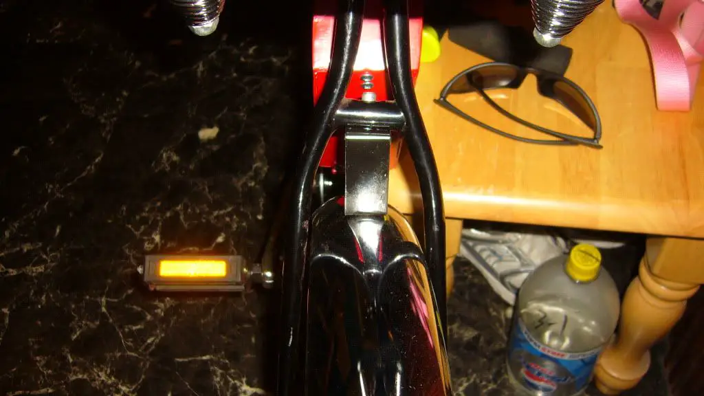

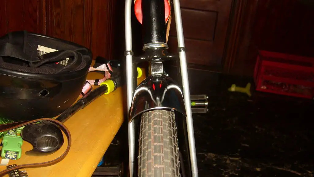

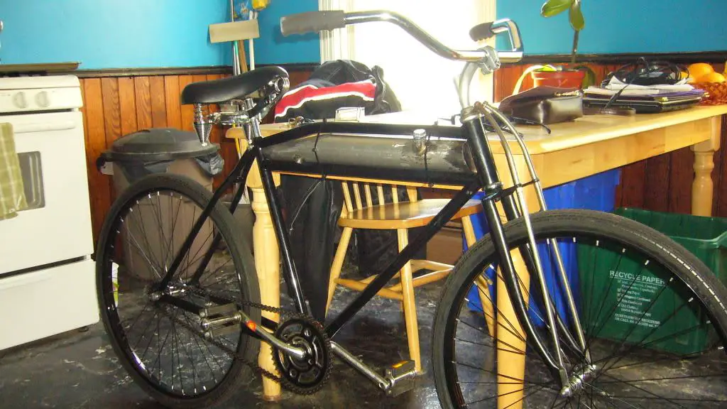

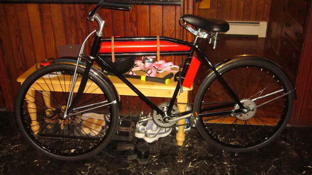

Well i found out some info on my frame and fork. Turns out it's actually meant for the older 28" wheels. I believe it falls into the mid to late 20's
I realized this when I tried to mount the new fenders. I had to make some steel adapters to space the fenders to fit the 26" powder coated wheels i bought for the project .
It took an extra day to mount them ,But i think it all looks good now.
It's always something with an antique build.
