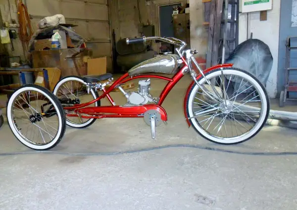

Heres the start of the wifes beach trike , she has got the reins on me preety tight so I dont get carried away an build her some crazy low custom , any way the new front wheel arrived sturmey with drum brakes , an almost all of the trike conversion parts are here fenders an struts, rear brakes , taillamp turn sigs for the rear, axel adaptors . couldnt handle it any longer an had to build the front wheel an get it installed. cant wait for the motor an jack shaft an a crap load of other stuff to get here ! so we can go ridin !

That's very shiney and clean, Gnu!
Glad to hear your wife is excited about her project.
Mine... NOT interested much.
Had trubble getting her to ride a bicycle for a few minutes today...
and she's always happy when she comes back!
Maybe I should try building a nice pretty one like you are???

RC she had told me as a child she loved to ride , an when the 2 of us have time we both love going to car shows / an bike shows . with this build SHE has the vision I have the skills . maybe on monday I will head over to valley steel an get some 16 gauge an start wheeling out her tank. where she also mentioned (that means do to me ) it should look like a fat boy harleys with dual fillers been a while since I wheeled something like that so the tanks gonna be my biggest challenge

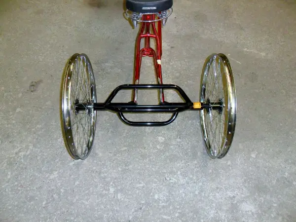

Well fitted up the rear tonight , didnt bother to hang the fenders an onther assorted stuff , but made darn sure the 3 spd rear fit before I welded it in place , also measured it out like we do for cars that rear is only 2 mm out of perfect square .
I also scrapped the dash after 3 failed attempts , next time I build a tank with the dash planned in first , not as an after thought. tomorrow I modify the stock chaingaurd an maybe take a day off the fab work an go home early.

2 things left to do fit up the rear brakes an fab mount brackets, an build the exhaust after that paint an build. then all the gingerbread stuff I plan on making toung an groove bed with stake sides , oh an I found hub caps in a hardware store you will have to see them when done . I also managed to get the stock chaingaurd to fit without big changes .
