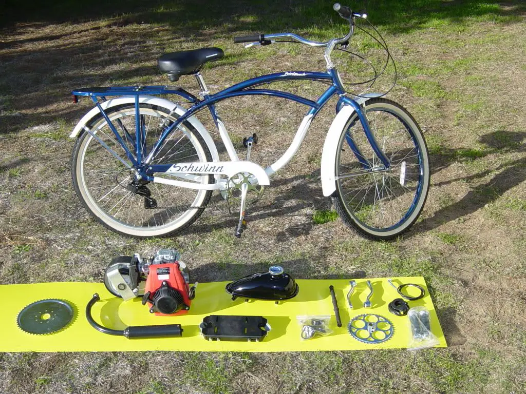

Well. today my delivery from Bicycle-Engines. com arrived.
Now the fun begins! This is my first 4 stroke build, but definitely not my first build.
Here's the victim:
Or is it patient? Hmmmmm.......

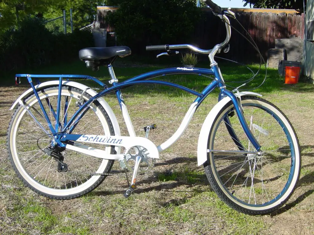

It already has a Staton 48 spoke dual threaded hub rear wheel installed for sizing, ect.
Here's most all of the goodies that will soon decorate the poor little bike.

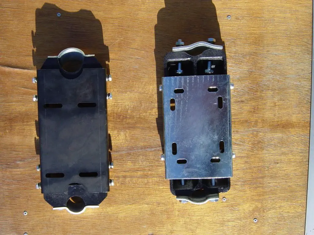

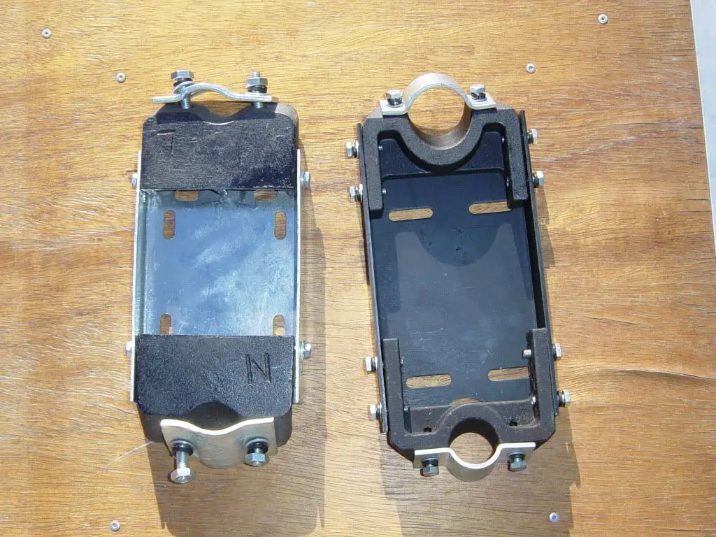

Here's a compairason of the EZM engine mount plate and a Grubee one.
EZM mount has the silver plate, Grubee has a black plate.

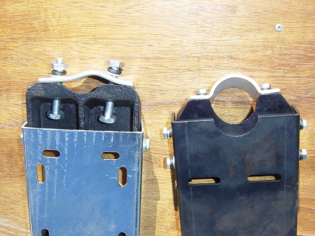

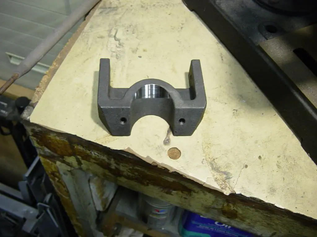

A closeup of the front brackets:
Today I spent about an hour and a half filing and sanding the rear mount of the Grubee plate for a precise fit with the seat tube. It nearly snaps in place now.

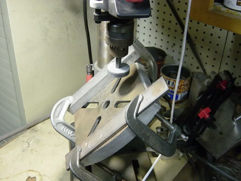

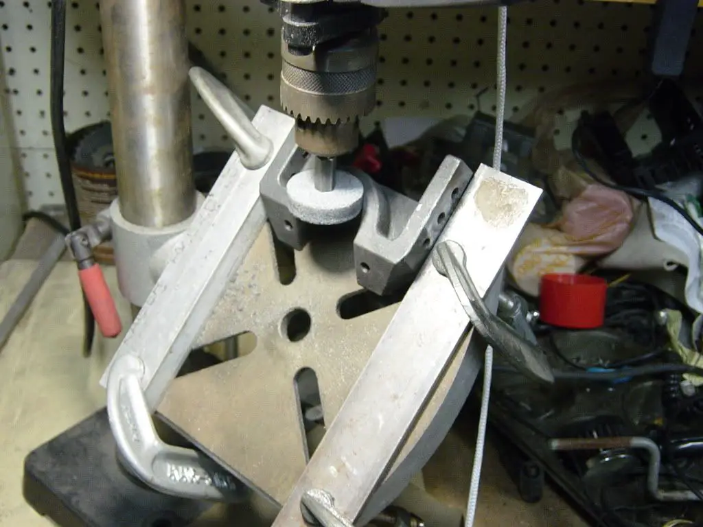

This weekend I was able to get a couple of 1 1/2" grind stones and a 1 1/2" sanding drum kit to fit the front mount to the bicycle frame. The mount is made at approx. 60*, the section of the frame where the mount will sit is 43 1/2*. Some angle adjustment is in order.
I set up my drill press to grind the mount and worked on that for a couple of hours today. It will be a slow and long process, but worth it in the end.
Gosh GN... THAT is a way fancy way to get those mmts at the proper angle!
...I just took a 1/2 round file to mine to adjust the angle for best bearing surface. lol

rusty, I at first tried a half round file and quickly decided that it was too slow and too difficult to control the exact angle needed.

This evening I finished up the re angling of the front motor mount. No pictures of it, not much to see really. The mount fits snug and the plate is dead level with no twist or torsion.
