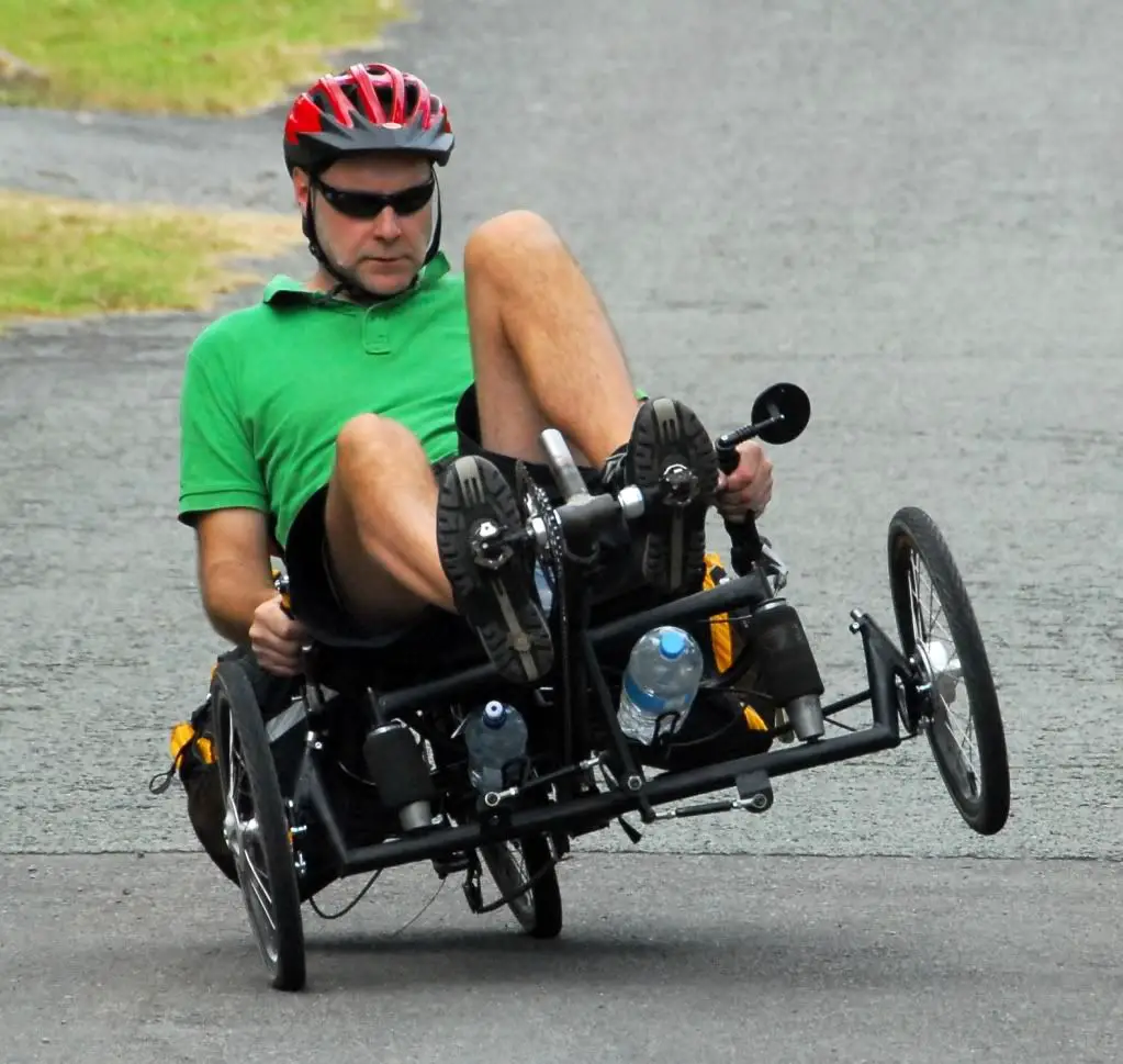

For a potential front suspension, I stumbled over this simple yet effective setup that although it's a recumbent pictured - I thought it sorta well-suited for "blending" into an upright vintage design...
More pics here: Pictures by JulianEdgar - Photobucket (last page)
While the "small coil spring" in the Indian pic is simpler still, a large chunk of channel/C stock with two holes, a sideways "T" - being your spindle & a vertical shaft w/the spring around it... it's old school alright, some gokarts & whatnot still use it - & it's pretty rough. It'd be easy to replicate and would be "period" tho...
