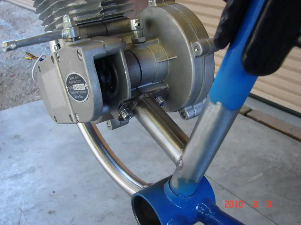

Hi Guys,
I think most people that frequent this forum are aware of the stainless in-frame gas tanks that I build. As the months have passed I have developed other items for that board track racer look like drop handlebars, layback seat posts, oil tank/tool boxes and other items. People have encourged me to expand into frames. I finally agreed to build a run of frames if five people came forward. This would allow me to spread the development costs and design time to make the project possible. Well, five people came forward, then more. Now I have some results to show. I basically designed a series of frames for different engine packages. The first model is the Sportsman Flyer Deluxe. This model is based on the Worksman Industrial Newboy frame with a loop down tube to allow more engine space for the typical two stroke application. While I was at it I added welded in engine mounts. You can walk up to this frame kit and bolt in the engine in less than five minutes for a perfect fit. This required engine placement then allows me to offer all the additional components like intake and exhaust manifolds, welded on idler assembly, reinforced Monark forks and pre cut chain knowing that they will fit correctly. Here are a couple pictures showing the frame and then the basic kit.

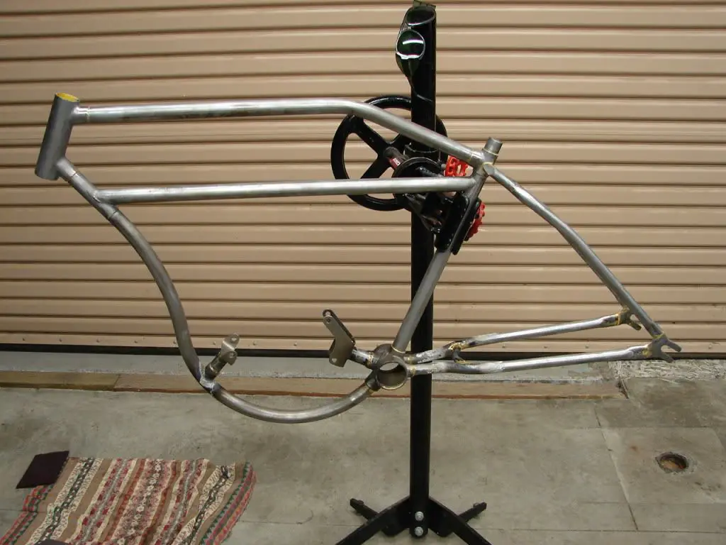

The next model in the Sportsman Flyer line of frames is the Sportsman Flyer Racer Deluxe model. This frame is Cad designed as a 4" stretch frame with deeper loop. It is designed to carry the 9.4 hp Morini S6-S engine. The frame is built on a proper frame jig and is both tig welded and brazed together. All factory style Worksman lugs are brazed and various other areas are tig welded together. Down tubes are CNC rolled to my specs. These frames are straight and true. Parts are interchangable between frames. These are not one-off frames but part of a very small production run. Each frame receives a serial number and build certificate. They will be sold as kits only with weld-in engine mounts, idler assemblies, both tanks, and forks. Here is a picture of the first Racer deluxe before final cleaning. If you look closely around the frame you will see flux still on some of the lugs and some tig welds that still need to be dressed down. I took this first picture when the frame was still warm. If you look closely you will see the original INB rear frame triangle and lugged head tube. Beyond that all three center tubes are new. The middle tube is even jig located to assure a tight fit to my soon to be built 4" stretch in-frame stainless tank.

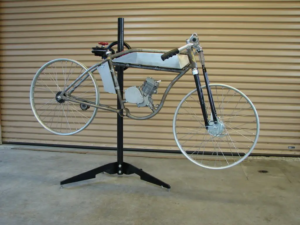

This next picture shows the first mock-up with engine mounted, forks and wheels installed and both bike and motor chains routed with proper motor side idler assembly.

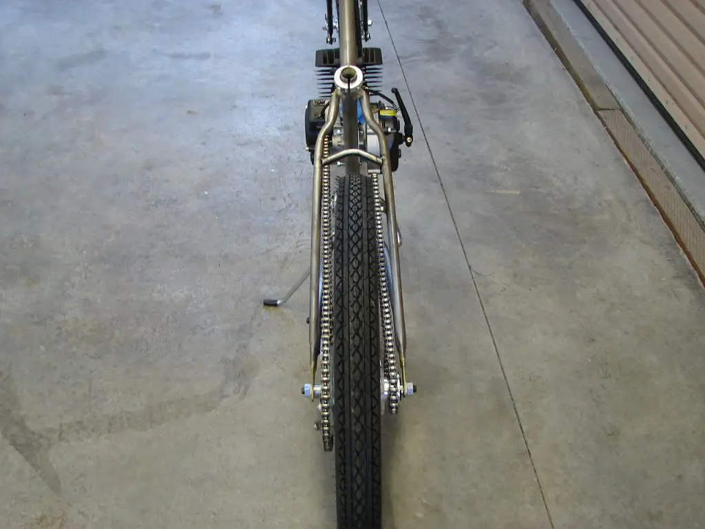

This next shot shows a rear detail of the bicycle and motor chains. The frames have been widened to 130mm from the stock 110mm so that the Morini engine sits centered in the frame. Rear hub laced into the Worksman wheel is a heavy duty drum brake with 45t motor side sprocket and 18t freewheel on the bicycle side. I expect mid 50 mph performance out of this chassis.

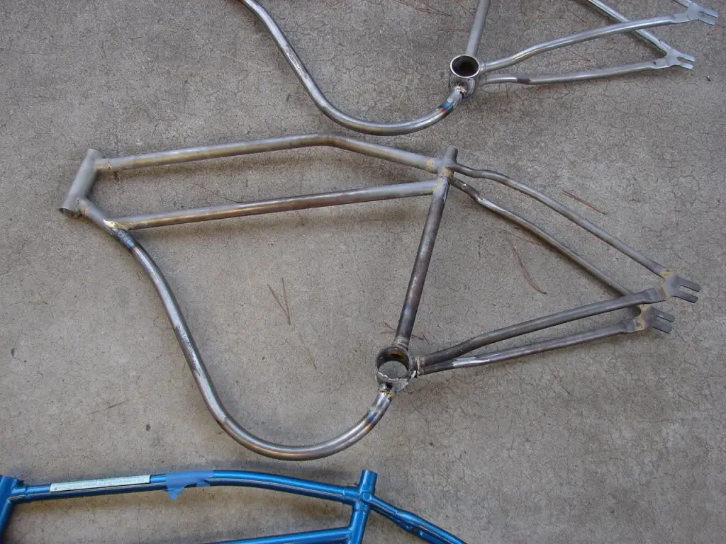

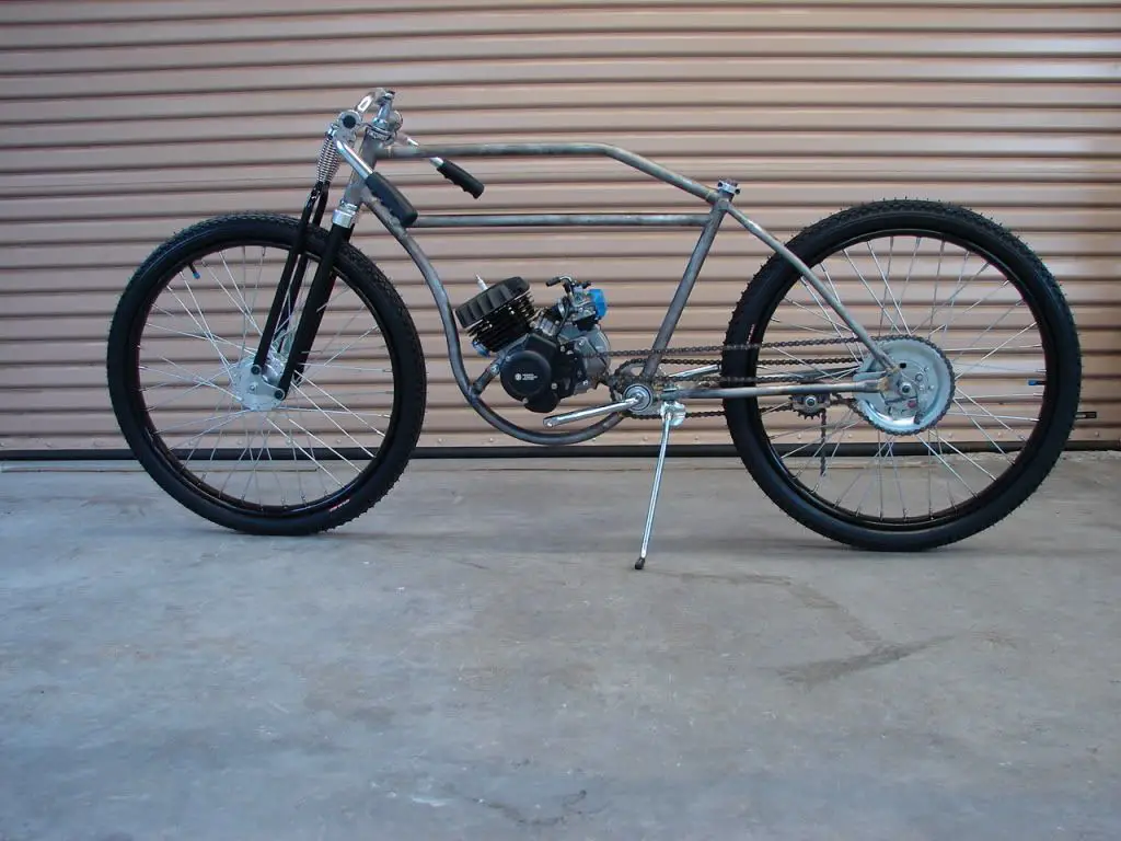

Just wanted to update this post with an early picture of the first "WZ" Flyer frame. Still needs mounts and detail work. Notice the deeper loop with tighter radius.
