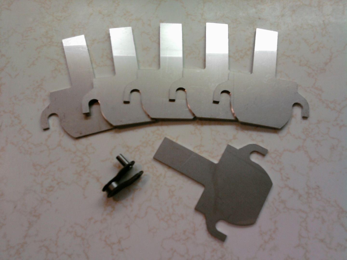

Something like this in say 1/16" to 1/8" would be perfect. Maybe a kit with a few of each size.

Kevlarr, What you have pictured there is close to what I am producing as a tensionerless chain tensioning system!!

As far as the rear first?? If you need to do the front, why do both? I know that they are out there, but out of 5 builds I have not had one that the front matched up perfect. It takes a 75 degree "V" for a perfect fit.
i do that all the time. seems like all my kits have come with an extra mount, so i've cut them down and made spacers outta them. sometimes i need a 1/4" or so just to get the chains right so i don't need a tensioner.
i've also used the "large frame adapter" chunk of steel (used by those people crazy enough to drill holes in their downtubes...) as spacers.
and as for your idea of a spacer, i've made some exactly like that. loosen up the bolts and slide them right in...
Here's a pic of my new 'tensionerless' chain tensioner system. (to get rid of those evil rollers.)
First you install the BMX 1/2 link on the pedal chain; then to get the engine chain tension perfect, you simply slide these shims in between the rear mount & the engine. (& as the chain stretches over time, you can simply add another shim to re-tension the chain again!
The shims are laser cut from stainless steel (to prevent rust), have a built in handle & are shaped to make them easy to install.
I've tested these on several bikes with great success.
Each kit will be sold for $30. (as pictured)
