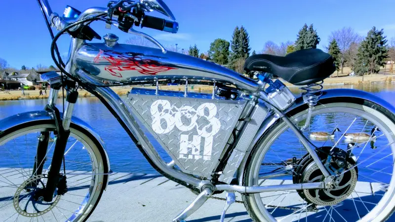

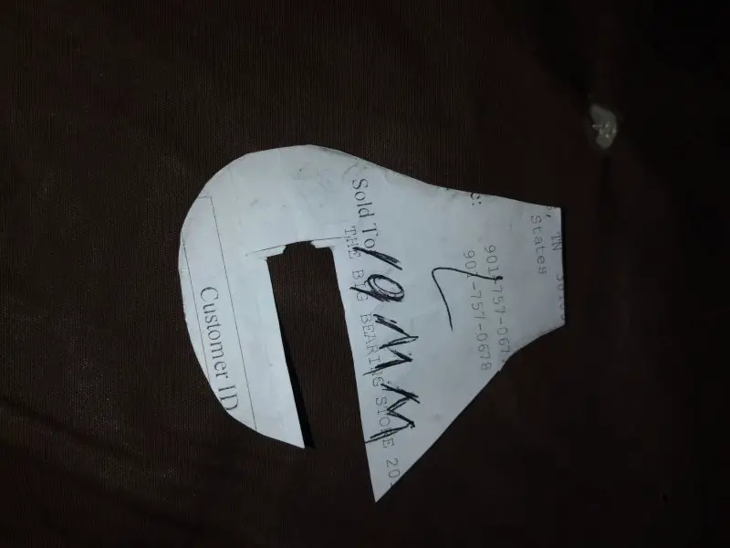

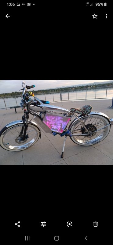

I've been using the aluminum GT frames for years now building gasoline bikes I never had any problem I have been building electric bikes with the same frame and a 5000 watt motor and a 72 volt 35 amp hour battery this bike will do 70 miles an hour aluminum frame hi power motor without spinning out in the Dropout and no cracks no problems whatsoever if you're worried about any kind of strength in your Dropout all you got to do is notch some quarter inch plate steel screw that on the outside of your dropouts and you will never have a motor spin out or any problem and with using these aluminum gas bike frames for electric bikes you get too poor gin and juice out of your gas tank LOL
