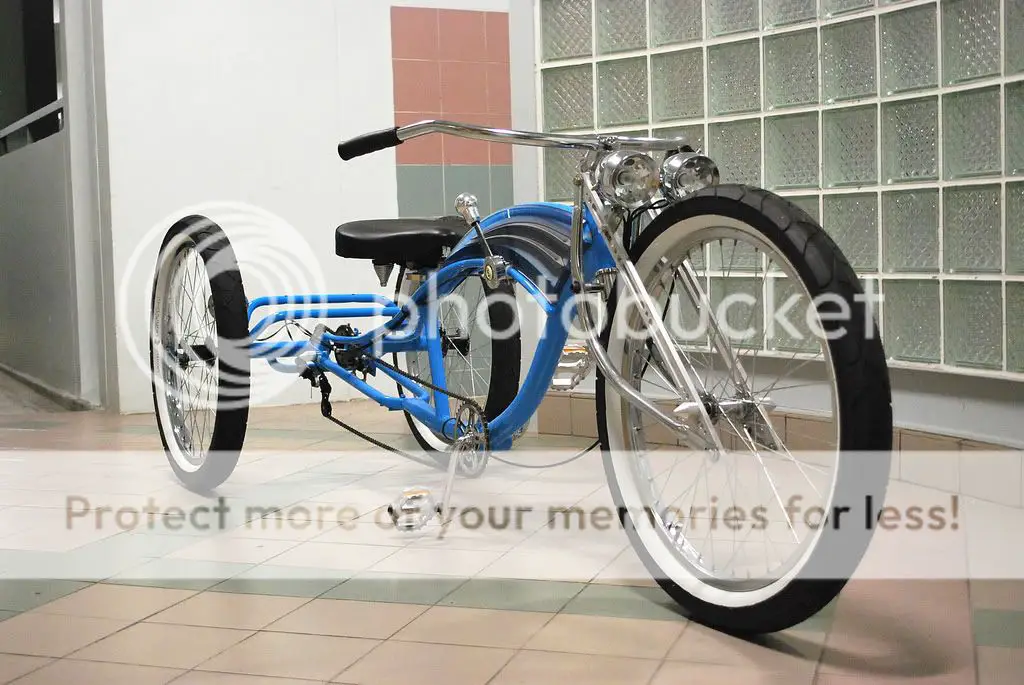

Yeah ..... thats what I was talking about Yesterday!! I love that trike.Its called The Singapore Stretch.

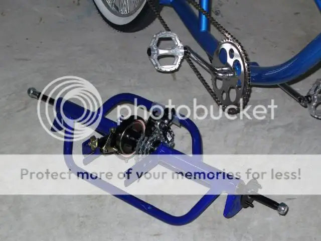

That's a nice rear conversion kit. Is that a drum brake? It looks a little different than ones that I've seen. I like the multiple gear rig on the rear axle. I was thinking the same thing with my new stretch build, but only after I add a jackshaft behind the rear seat post. I like how low you got it to the ground, you can tell by the two rear bars on the rear that are supposed to be flat for a basket, lol. We used to call these puddle dippers. Cause the rear of you pant legs would drag in the puddles in the street. Can't wait to see it motorized!
Thats a rear end from a Gomier trike with gear cluster and drum brake here is the build thread.... ratrodbikes.com • View topic - the singapore stretch

Fairracing, The Tire's are Fatty-O's White Walls.
This is builders name and a lil info bout this build hope this helps:
OWNER: CHUSAN
STRETCHED CRUISER SLOWRIDER TRIKE
"THE SINGAPORE STRETCH"
STRETCH'D SLOWRIDER WITH 90 DEGREE BENT SPRINGER FORK OPTION FROM BICYCLEDESIGNER.COM
MATED WITH A GOMIER 5 SPEED INDUSTRIAL TRIKE REAR END
CUSTOM FABRICATED BILLET ALUMINIUM LOWERING FRONT STRUTS
24" RIMS WITH 24X3' FATTI-O WHITE WALLS
PIGMENTS BY SULAIMAN OF THE REBOUND CENTRE

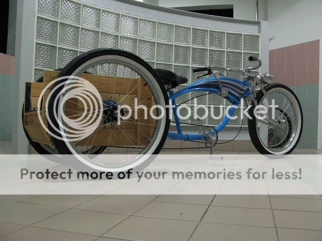

Chusan's updated pictures, shows the bike now fitted with a rumble seat style or vintage delivery truck bed, very intricately designed and constructed, very clean!
I just had to share this version of a Firmstrong & Greenline Stretch Cruiser Bicycle with Trike Conversion Kit, so that others would likely be inspired to brainstorm their own Stretch Cruiser Trike.
Here's all Chusan's, picture's of this build click on the below Link:
side rear shot on Flickr - Photo Sharing!
Peace Crazy Horse.

Alex,
This is all the info I have on Chusans Trike Conversion Stretch Build, he is a member of another forum it's RatRodBikes.com haven't seen any posts from him in quite a while.
His most updated photo shows the bike now fitted with a wooden rumble seat style wooden box, very nicely constructed, very clean!
Here's all his photo's of this build:
Peace Crazy Horse.
