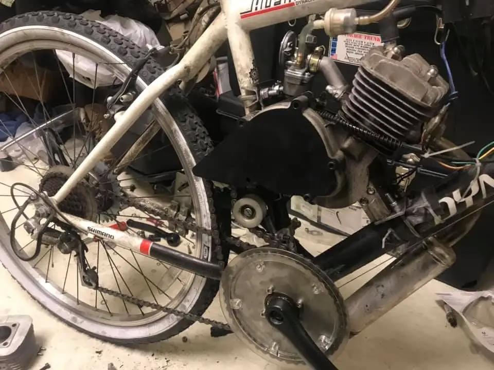

Hello all. Im stationed in Korea right now and needed a way to get around since the Army wouldnt let me have a car. So I built a motorized bike. I recently installed a shifter kit. And let me say I will never do that again. But anyways, one of the issues I am having is that when I am in the higher gears my two chains like to touch. I spaced the sprockets further apart then the way they came but still having the issues. Also, my original bike chain didnt fit on the front sprocket that came with the kit. I had to bevel each tooth on the gear to get the chain to seat. Is this a common problem?

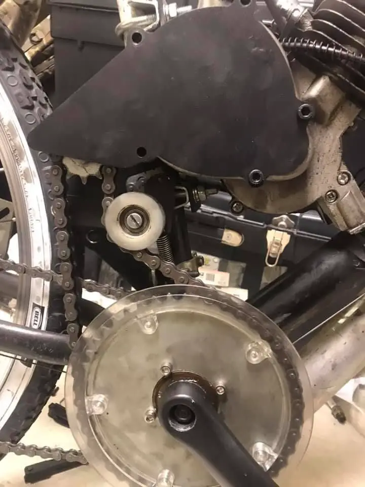

Here is my shifter kit. The outer black protective cover only has two bolts holding it since its not a load bearing member. But there are bolts under the black plate through the clutch cover holding the brackets on for the kit.
I rigged up a spring loaded lever to keep tension on the chain. The shaft to sprocket chain is the 415 chain that comes with the standard engine kit. The slimmer chain that came with the shifter kit was not long enough. If someone could point me in a good direction for the slimmer chain for this point I would be grateful.

First of all, get rid of the spring tensioner & make it a solid tensioner!! (the spring will still let the chain bounce around at high speed).
Second, you might try using a #410H chain for the right side of the jackshaft.
#410H chain is thinner & still plenty strong enough to use.

Right now I dont have the means to make a solid tensioner. Its a pretty stout spring and its on the coasting side of the chain so it shouldnt move much. I found out about the 410 chain about 30 minutes ago and already ordered one along with a half link just in case. Maybe by then I can figure out a solid tension solution. I also found a picture online of a guy who made a spacer plate between the two chains. I rigged something up for testing purposes and we will see how it goes. Right now its a metal plate but ultimately it would be ideal to be plastic or vinyl. The plate goes in line with the lower part of the frame so the chain doesnt catch when it is in high gear. The driven chain also doesnt catch and will just skim it occasionally. Maybe once I get the 410 chain in then it will allow for more clearance.
