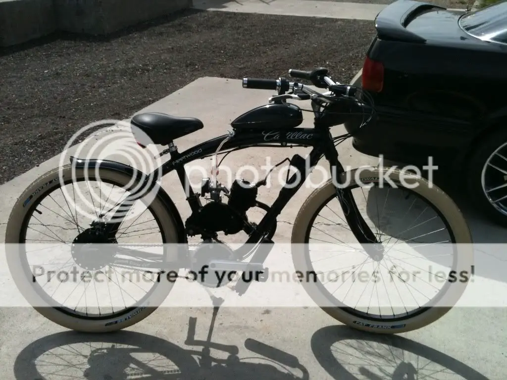

ChopperDave
You should go to a junk yard and get a Caddy emblem for it! Looking good!
Terry
I see that it doesn't have a front brake. Does that disc brake stop it good at speed?

Nice looking and sounding bike, Dave. The Fat Franks add a lot to the look. Nice frame with lots of room for the motor. A front brake would be good. Love that SBP shift setup. (Not that I have one). It makes a big difference, doesn't it!
