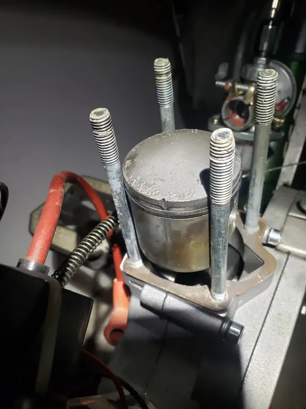

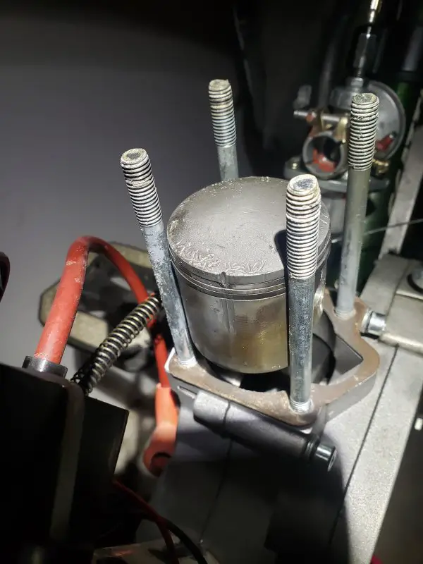

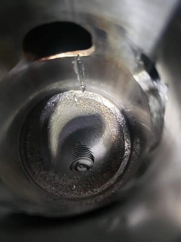

Well yes, it is just as you suggested. Pity.
Piston scored, cylinder scored, rings... look ok. It seems something got chewed up in there, dings all over the cylinder head.
Replacements ordered.
I want to be sure whatever it was is out of there and not blasted back up from the crankcase.

I would wash the crankcase out with fuel, stretch a towel or old tee shirt over a bucket and pour the fuel through the cloth to catch the debris. You will probably find a lot of fragments.
Are both cir clips still in the piston? That’s what the piece of metal looks like, if you have both intact the person assembling it at the factory may have dropped one.
One wrist pin clip missing. And looking at the piston, it was clearly clip shaped damage. Surprised me as I thought the pin clips were not directly under stress (unlike the wrist pin itself).
