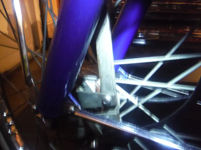

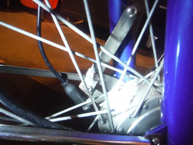

Question for those of you that have installed Worksman (drum brake-equipped) rims on their new edition Whizzer's.
I've noticed that the fork mounting bracket is bent so it will not fit between the forks (unless the forks are spread a 1/4") and it is too short to reach the attaching bolt thread on the fork. How have you guys dealt with these issues?
Easy solution is to make a bracket

I was looking for a picture like that! Nice! I know they do have that bracket set up on some of the modern whizzer.
