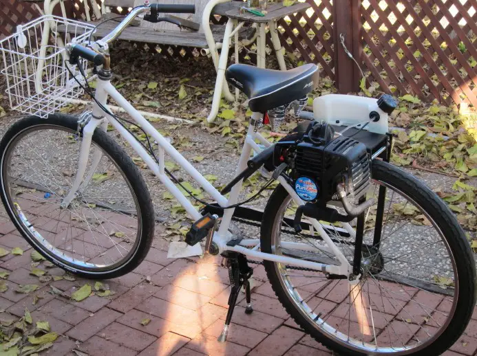

Raked up another big leaf pile and blew out them gutters again. Time for a reward. Cruised the hood and found that lots of folks had big leaf piles - :)
Love the bike. I have a cheap rear wheel on there with a cheap China coaster hub that's making all kinds of strange noises. Runs smooth & true, but I don't like strange noises. Gonna get another one with a good hub. The motor runs sweet. The idle is smooth as silk and I can hear intake noise - :)

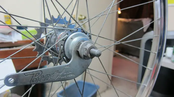

I just got a nice looking 26 x 1.75 rear wheel with a Bendix coaster for under $40 shipped.
Off a Spaceliner. With a big red groove down the middle of the hub. Made in USA.
My wheel arrived in good shape, exactly as advertised. New red grease seeping out confirms that he cleaned and regreased. I love ebay - :)
I got right to work too and put on that "biggest I could find" 23 tooth Shimano cog. No, it didn't fit, so I had to make it fit with a little Dremel work. Nice wheel, heavy guage steel, lotta bevel on the rims. Caliper brakes need not apply. They don't make 'em like this anymore. Runs true and smooth, no "weird noises" coming out of hub.

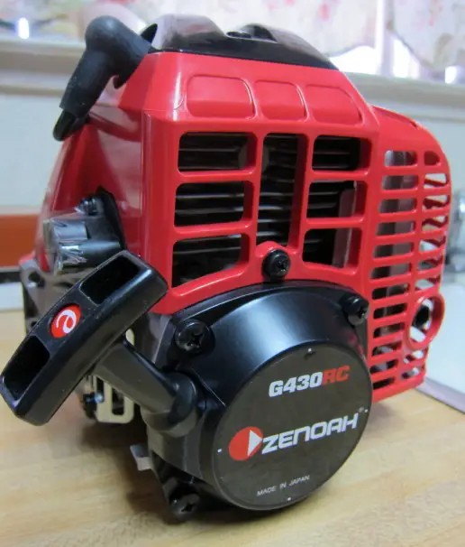

Also got me a bigger motor just in case. A 41cc 2 HP Zenoah. Pretty eh?

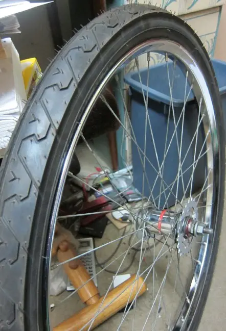

I'm ready to go. New tire, new tube, new rim strip and new sprocket;
On a 45 year old wheel. Nice tire eh? Kenda round profile smooth. Figured this would be good for a friction drive.
Next weekend. Got a brand new KMC gold chain too. We be stylin'

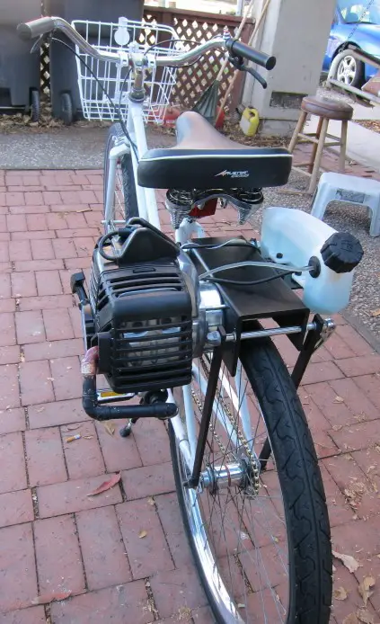

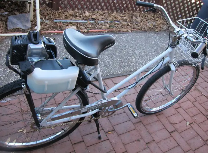

Took it out for a ride and it runs good. Got the new gold chain on and new pedals too. Had to redo my strut brackets for the larger sprocket. Some weird noise was going on too which I found was 2 bad brazes on my pipe, the first elbow to the muffler nipple and the one I brazed upside down. Gravity was not on my side. Removed the pipe and brazed it up as 1 piece. Now only the muffler tab holds the whole thing on. I'll ride it a few months and then wire brush and re-paint.
Took some advice I found here and got me some cool stop brake pads.
Yup, expensive and worth every penny. They work great! I have no worries re stopping anymore. If you have rim brakes, get some of these.
I'm jazzed! I love this bike. And it's gas too but I prefer electric. But it has a step thru frame and that's a big plus.
Gassed up and ready to go. Don't you wanna just hop on and ride?
Looks good! Clean and simple. You should get years of enjoyment if looks are any guide.
