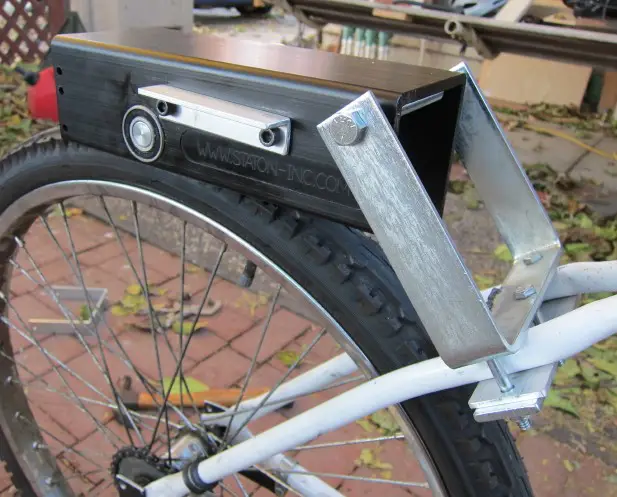

The Staton bracket was test fit and looking good.
I love this bike. I just love step thru frames, they make life easier. Bracket fits nice, pretty level eh? I'm going to do another remote gas tank on the side opposite motor for the sweet "balanced" look.

Welded a stop on the steel bracket today so it would square up against the fender support. I verified the support was square yesterday. That will make install easy. Also cut off the bottoms of the old Solex brackets they will be used to mount the uprights. Not going to screw with springs, the squewer and struts are nice and proven.

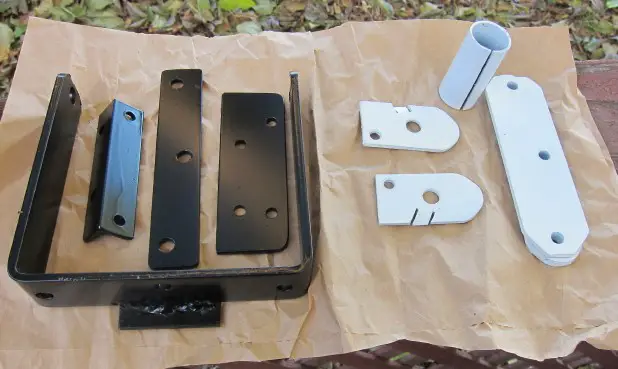

Gave up on the copper tubes. pain in the butt. Made an aluminum backing plate and it works good. So good that I think I'll make another tomorrow. The soft aluminum crushes to the steel and is nice and rigid. Going to round over those nasty sharp corners on the steel bracket too. After I get it all fit it's all got to be removed for paint. Ain't gonna be no big naked plated steel bracket on my ride!

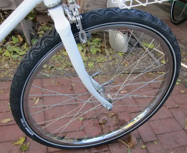

Also got the gas tank side bracket done, the struts figured out and yeah Baby, a new tire. Michelin City. Radial. Nothin' but the best for my baby!

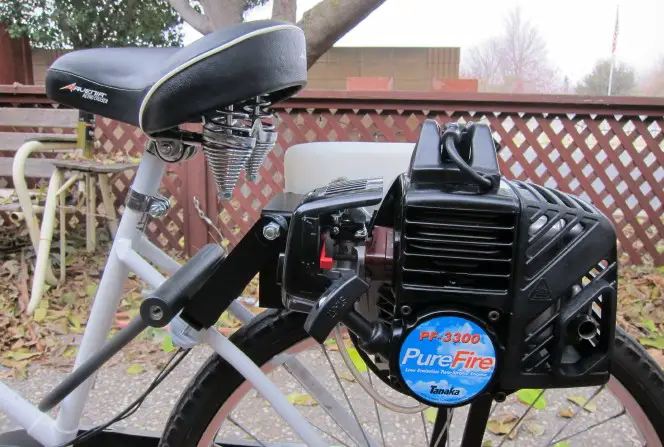

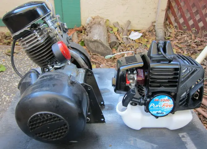

A Tale of 2 Motors
Side by side.
The Solex weighs 18.6 lbs, the Tanaka 6.2. Without that gas tank on there it's gonna look even smaller. Tiny. Itsey-bitsey. Sweet.
Got everything painted and ready to bolt on, today wasn't very exciting, like watching paint dry.

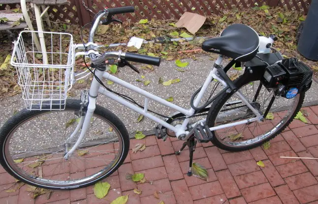

All Done!
Took it for it's first ride. Sweet. Strong, smooth, responsive. Dunno how fast it was going, made my eyes tear, so had to be at least 20.

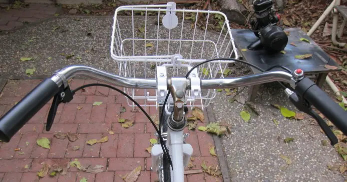

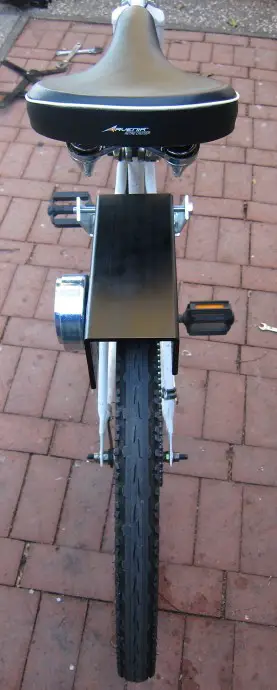

View from the handlebars. Simple, neat. Gas, front brake, kill switch. Way better than that Solex pig motor you see in the backround. Time to drain the gas and throw that POS in the trash. Was advertised as a "new" motor. The only thing new was the muffler. Utter crap.

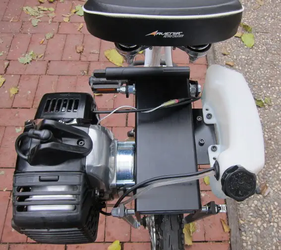

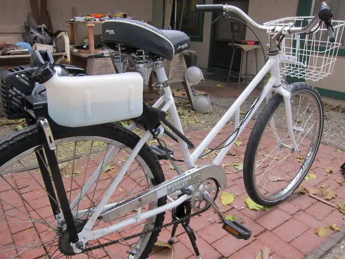

View from the back. A remote gas tank really helps the look of these things. As well as painting the hardware. It doesn't need to look like a refugee from a hardware store.
Removing the gas tank makes the motor look better too. Got my preferred (no match for 30" bolt cutters) 12 mm Master U Lock on there too. No bracket needed, sweet.
Gotta love blue gas and see through tanks. Always know how much is in there. Remote tank is easy to fill too. This tank is 1.5 liter, about 2X the stocker. You can also see how low it's geared. Sweet bike, I'm gonna burn up the rest of my 2 stroke mix tomorrow and mix me a fresh gallon.

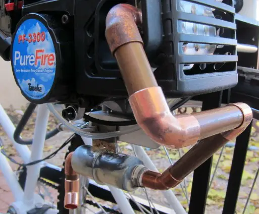

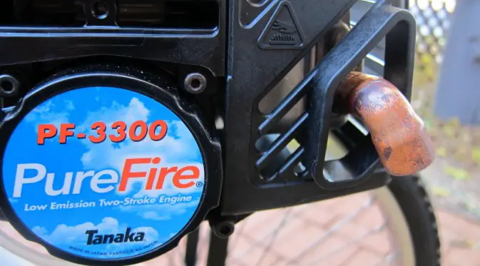

Step 1 of "mo quiet, mo better" brazed a copper street elbow to the steel exhaust nipple. The alignment had to be just like this or the plastic shroud won't go back on.
Quieter already. At least the noise is deflected back and down.
And now I have access to a standard plumbing fitting should I be so inclined to proceed further into the realm of silence.
This bike goes as fast as I ever want to go on a bike like this. It's stable and doesn't scare me, but it's fast enough. I ordered up some soft brake pads for the front caliper, the hard ones on there are not "sticky" enough. The brake is good, it's a center pull, not as good as a cantilever but better than a side pull.

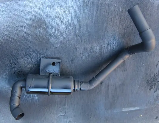

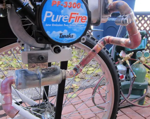

Got the muffler, cut off the thread and brazed on a steel tab with a little notch cut in to accommodate the roll crimp.
Made a bracket out of aluminum angle between the tanks bosses. This weekend I'll fit it all up with copper pipe and braze it.
I did one of these for the happy time and it really took the edge off.

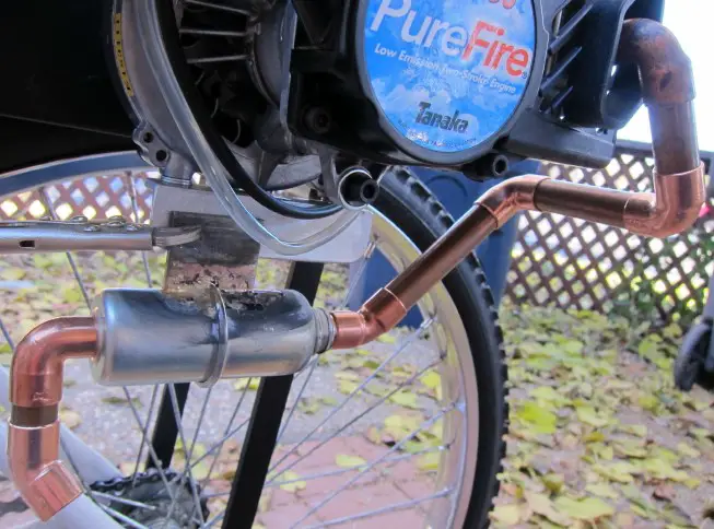

Silence
The quest for quiet - :)
Pipes all fitted and looking good.
From both directions.
I brazed this on the bike so all the fittings would be correct. Gas tank removed of course to prevent suicide.
I love my torch! I hate arc welders. Torching is easy, arcing is difficult. Ready for a test ride. The first elbow is brazed to the muffler nipple, but the muffler assembly is clamped at the elbow with a hose clamp the elbow has 3 slots dremeled into it so the clamp will work. It's a 2 point attach, the elbow clamp and the muffler tab.
The ride was wonderful! I lost about half the noise (almost as quiet as the Solex) none of the speed (well maybe 1 mph dunno) and now I can even poke along at half throttle less than 10 mph w/o 4 stroking & rough running. Wide open is smooth, fast and quiet.
It has been my experiance that more back pressure helps 2 strokes, keeps the charge from blowing out the exhaust port.
Now the shroud is back on and the hi-temp paint is drying.
