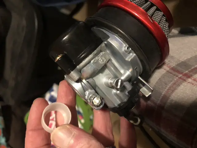

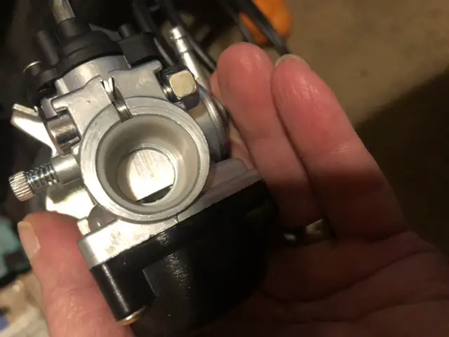

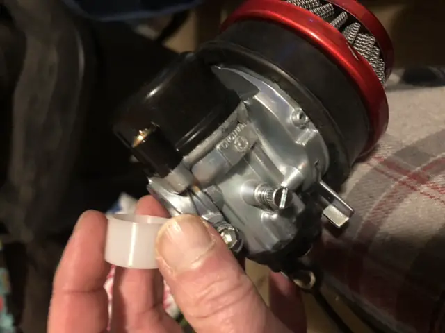

I’ll try that it’s a hp carb I’ll show pic of carb. When I did get it started it was very sluggish no power but it did get going after a while riding but idled great

I’ve had several of that type carb and had problems with the bushing getting soft and sometimes falling apart, I switched to the basic nt and found it to be much more reliable.​
Awesome I had a nt carb for yrs so I’m very familiar with them . Just got to seal the throat where it mounts to intake. Thanks .
