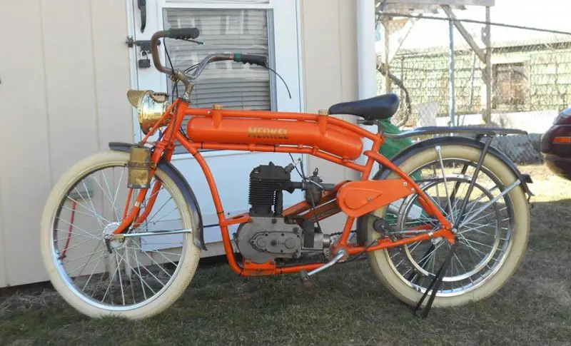

Hi , looking to find people of similar interest , you all seem to be the closest so far . I am building a motorized bicycle of the type from the 1920's . It doesn't fit with the board track racer crowd & I'm not sure what you will think of it . I will try to attach a couple pics as a way to help with my description .

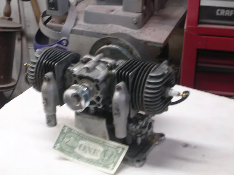

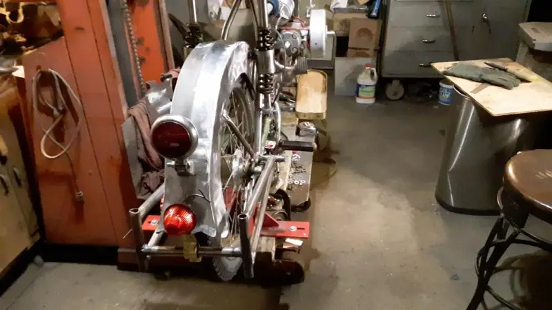

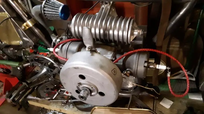

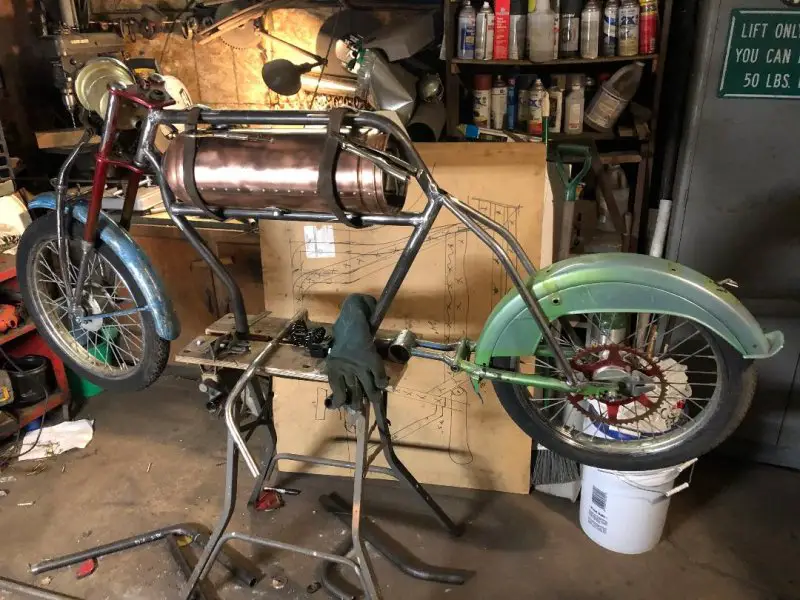

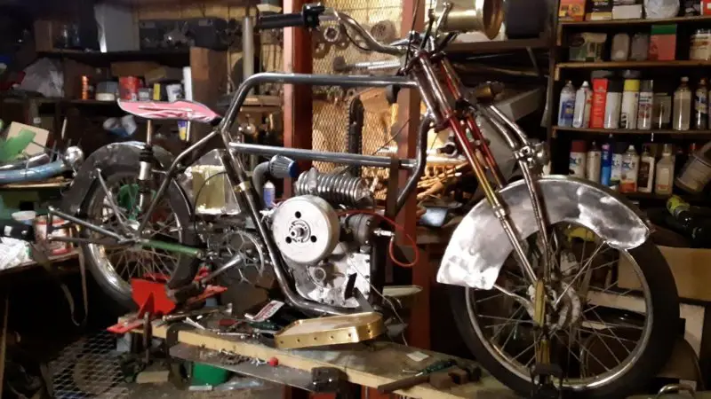

I harvested rims & forks from an old moped , then bent up my frame from 1 1/4 x .080 dom tubing . I used a 1938 Neptune Twin 4 hp , 50 cc opposed twin outboard motor powerhead to propell it through a belt torque convertor . The sheetmetal is all used 55 gal oil drums & gas tank is an old copper fire extinguisher . It is nearly done & is apart for paint & final assembly . Hope I have found the right like minded group . Let me know what you think or help me find somewhere to hang out ?
Thanks , Boo Long
