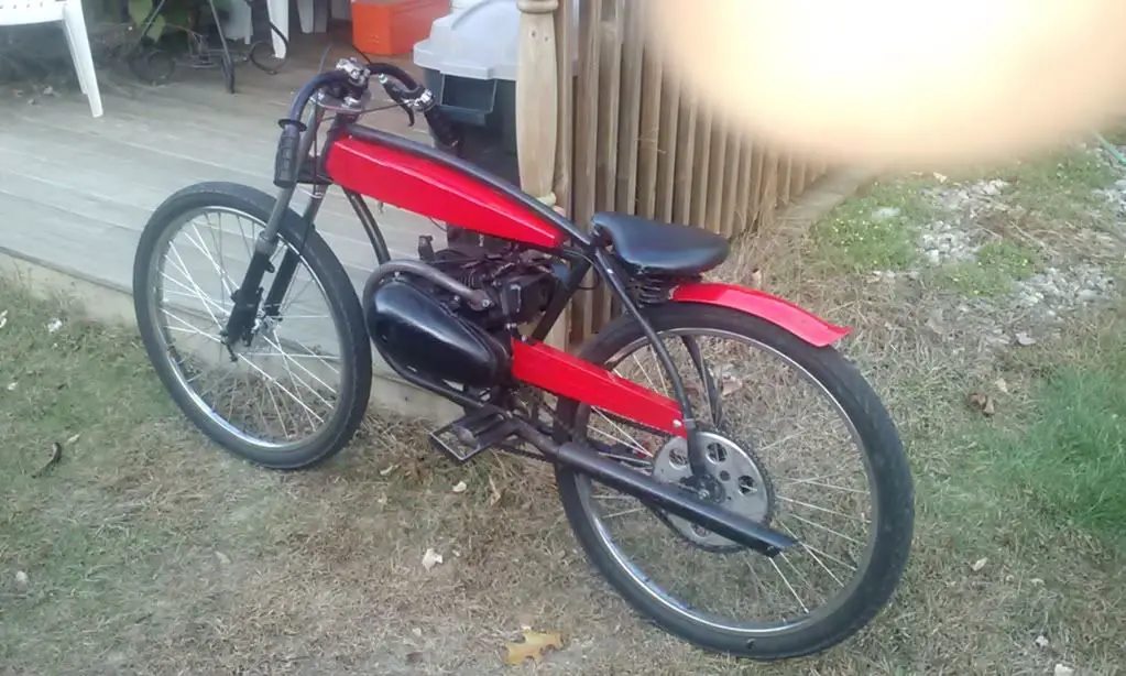

Just a quick update. I discovered my throttle linkage was only allowing for 3/4 throttle. I also rejetted the carb, and made a more free flowing exhaust.
This made a big difference in the grin factor. I had never gotten much over 5400 rpm 35mph out of the bike. But today I had to back out of it at 6500 rpm 42mph when I herd the valves start to float .
I also just picked up a 99 Whizzer front fork. I just need to fab some clip-ons to fit them, then i'll get some update pics.

Just thought I would post some updated pix of my 79cc build.
I added some 99 Whizzer forks, and painted the chain guard.
I made a more free flowing exhaust and rejetted the carb.
