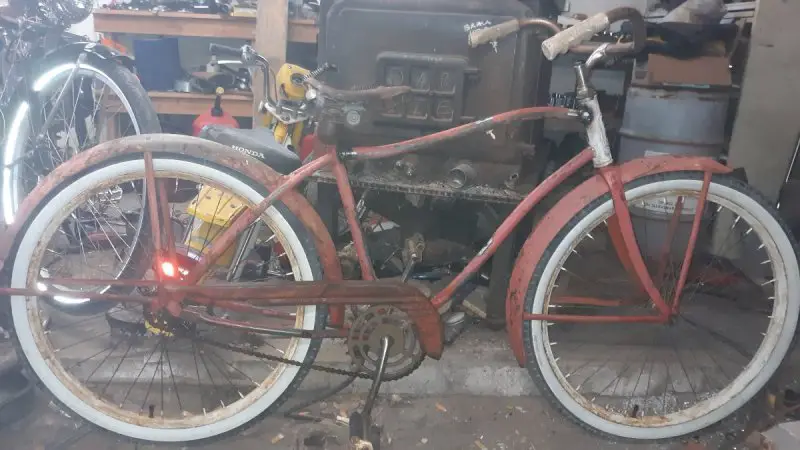

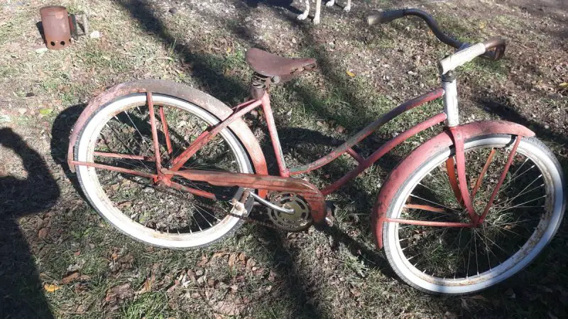

Will this bike frame take a motor?

Welcome to the forum, you can put a motor on that frame, the engine will sit higher and you’ll need a seat post mounted fuel tank. Some people cut the upper bar out and add a new top bar like a mens bike.

Thanks for the help and warm welcome Greg. Am currently looking into it.

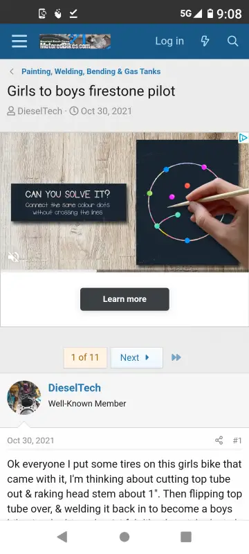

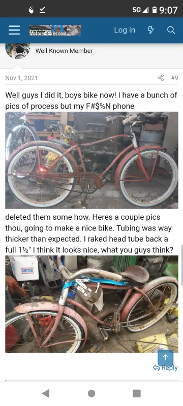

I've seen where someone cut the top tube flipped it upside down and welded it like a men's cruiser bike if you can weld

Les Miserable a thread by Old biscuit on here... Wasn't that long ago
