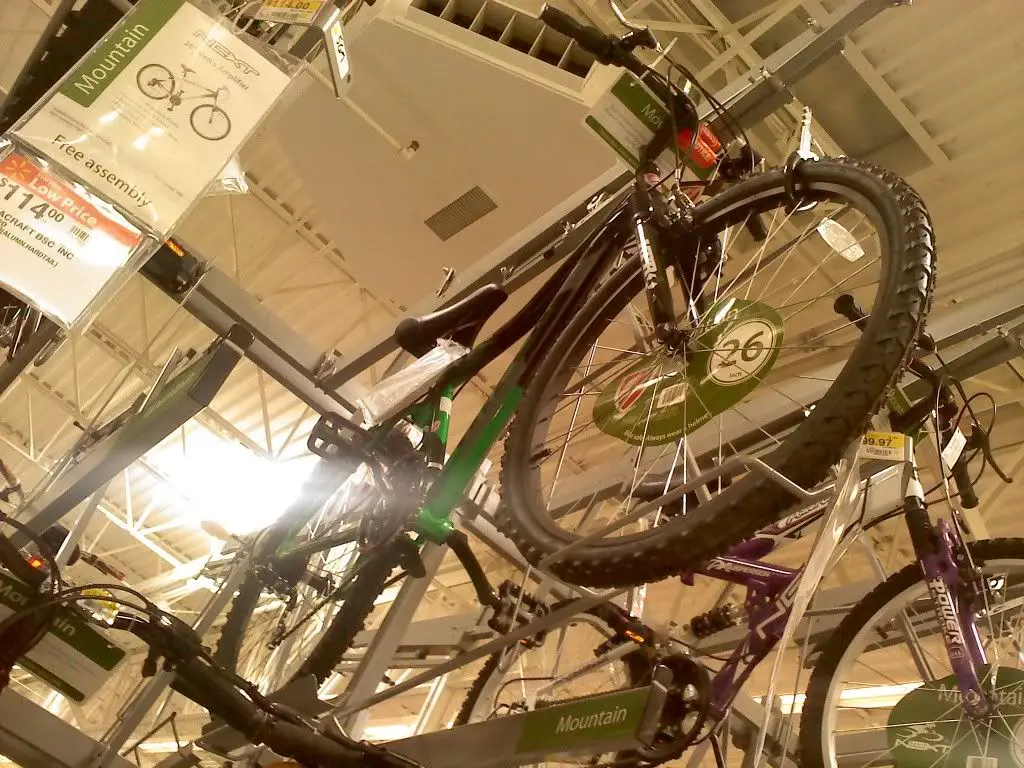

Step 4: found one, but don't think it will fit without some major modificiation and figured I would ask if anyone here has any experience with this bike and if it would fit?
Plus, it has amazingly strong spokes and a beefy frame.
Another bike I like, the rear suspension kinda worries me because of the slack it could potentially give to the chain. Any thoughts?

Hi and welcome to the forum. The Avalon isn't a good choice because of the rear suspension. The only way to tell if the motor will fit in the other bike is to measure it. If you drill a hole in the chain stay for the tensioner try and have someone available to take pictures of "how you roll".

As well, it can be done, doing a full ride/softtail motored bicycle, but - I wouldn't suggest it for your first build, stick to a rigid frame.

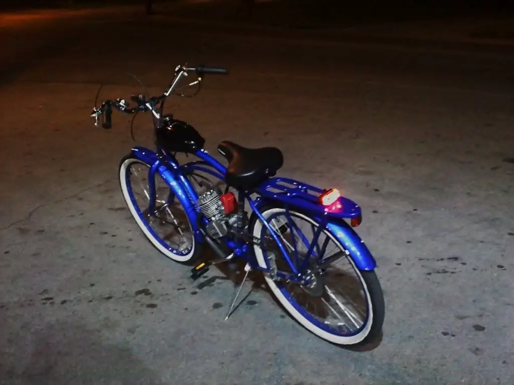

Engine installed and ready for first trial run.. Locktite everywhere.. did everything I knew what to do..and installed some front brakes off of a spare bicycle I had on the cruiser...
Now go figure.. my first problem after this entire install is...wait for it...
How do I get the gas cap off? No I am not kidding. It is stuck... I have no idea what is going on.

Be careful - sometimes the dog ear clip gets jammed up and /can/ flip out, rendering your cap useless. Push down really hard and unscrew it. It's just new rubber gasket material.

Thanks. Got it off. Road it around a bit.. Started up with no issues, but I just bought a new "non-chinese" plug for it to put in it anyway. Upgraded the plug wires and everything else that I said I was going to. Install wasn't that hard at all. Just a little cutting and modifying. Will adjust the carb later this evening and get it running better.. It idled well and all, but refuses to run at wide open throttle unless it is partially choked. Will post pics tomorrow.
