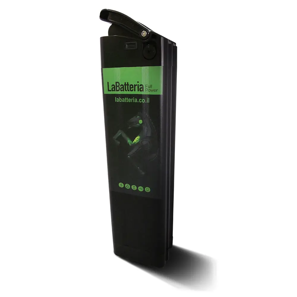

This 48V 250W bike comes with a 11A battery
If you change the controller and put in this 20A battery (48V)
will the 250W motor take it?

Since the batteries are the same voltage there shouldn't be a problem, going from a 11AH to a 20AH battery only increases the time it takes to discharge the battery. The larger amp hour battery only increases the reserve capacity.
