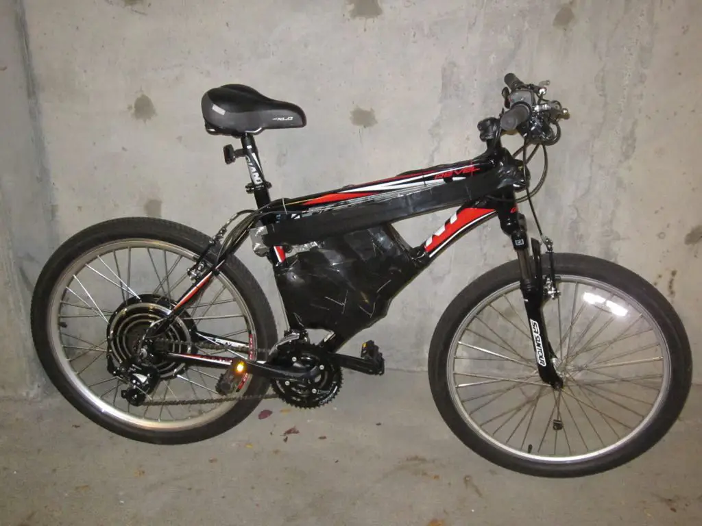

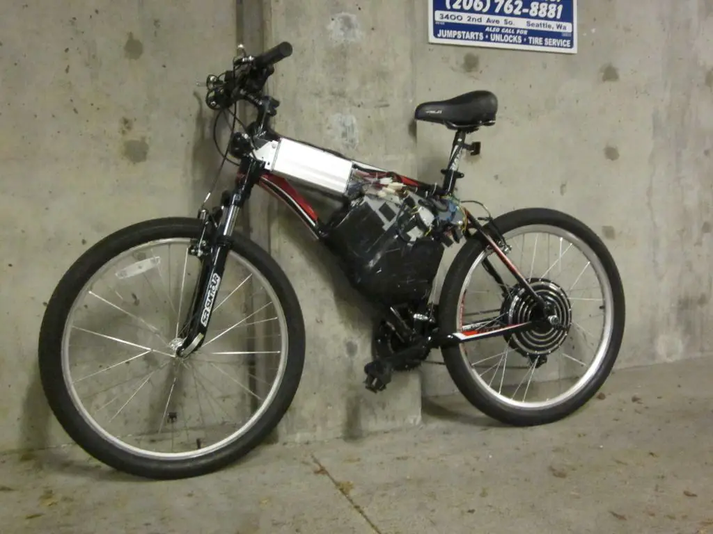

Here's the finished product. I mounted the battery right in the center of the frame on a brand new Giant Revel (aluminum frame). I have to replace the previous rear motor because I got angry and broke it or bent the axle- something. If you guys remember I got angry with my HT and beat it repeatedly with a hammer.
So here she is. I put dense folded shipping foam in the center between the battery and the frame to cushion it. I also bought "hole-y" steel frame straps at Lowes for $5 a peice (there's 3), used carriage bolts and lock nuts to the outside of frame- no drilling into the frame, and I got a bag of zip ties and a roll of Gorilla tape. It's all secure and looking sharp!
