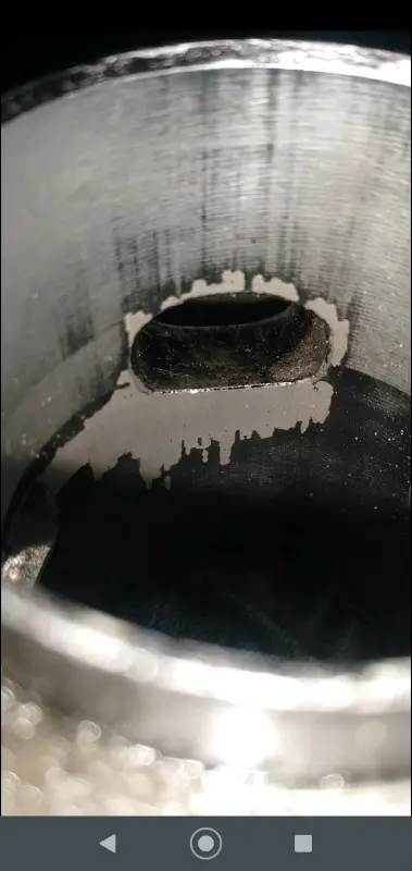

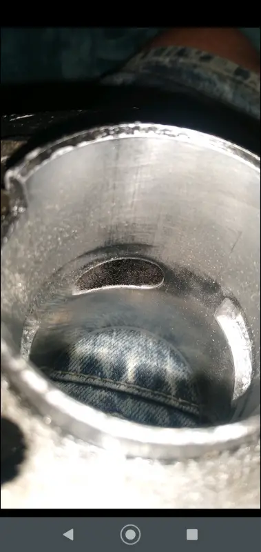

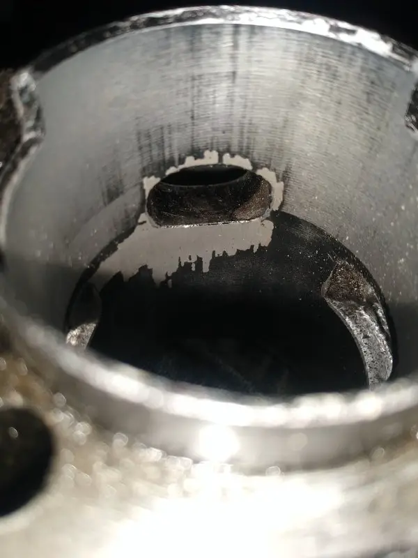

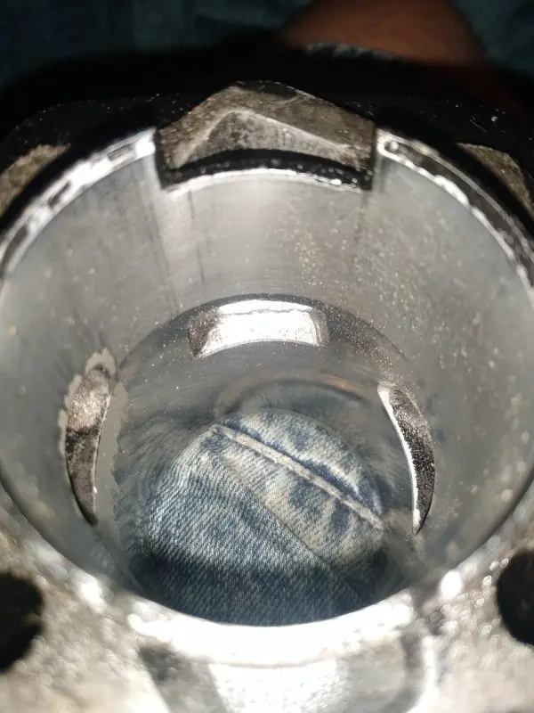

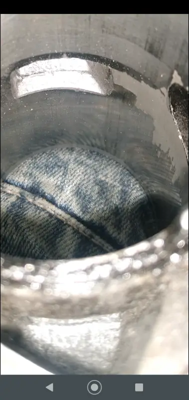

What would have caused this scarring on the cylinder wall?

Like I said in my previous post a neighbor gave me motorized bike and when I took it apart this is what I found and I can't for the life of me figure out what could have done this... so any input would be appreciated. Take a look at the pics.

This is a chrome plated cylinder. Very thin. It was manufactured improperly. Most of them are. What you have right there is a cylinder worn out. When the chrome plating flakes off the aluminum bore your pictures show the result. Over time this will result in power loss and a no start condition. Eventually you got 0 compression.
Greg makes an excellent point. when you get a new engine / or kit you must inspect the cylinder walls for debris and spalling. I have received brand new cylinders with the chrome plating flaked off right out of the box. Right now you need a new Cylinder and Rings.
