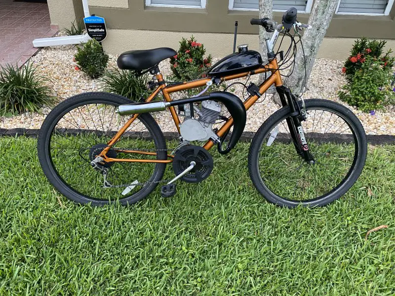

I’m running this set up, although I can’t compare it to the stock silencer since I just built the bike last Friday night and cut and slipped the stock silencer into the end to quiet it down. Paid $59 on Amazon and did it more for looks....the placebo effect has gotta be worth 1 mph, .

Yeah I'm not down with shelling out 75 bucks for placebo effect.

I was assured that the MZ65 doubled the power output on a 66cc China motor on another forum....”Dyno proven” in fact. Only dyno video on that pipe I could find was on a new motor and it netted another 1hp. Fortunately this one is a true expansion chamber and not a belly wrapped around a through pipe...what more it added, I have no idea. But I’d imagine it had to be an improvement over the stock silencer....other reviewers with broken in motors claimed it really helped. I was told the head pipe wasn’t stepped like an MZ65 so it wasn’t doing anything. Whatever, lol. But, again...I just did it more for looks than anything
Yeah I'm crystal clear on which pipe has the thru tube. The 20$ one. Not the $75 one. Thats cool you like what you got, I can respect that. $75 for me is high enough that it would have to go towards a trashed 65cc or 50cc bike search fund. Get a pipe. And everything else.

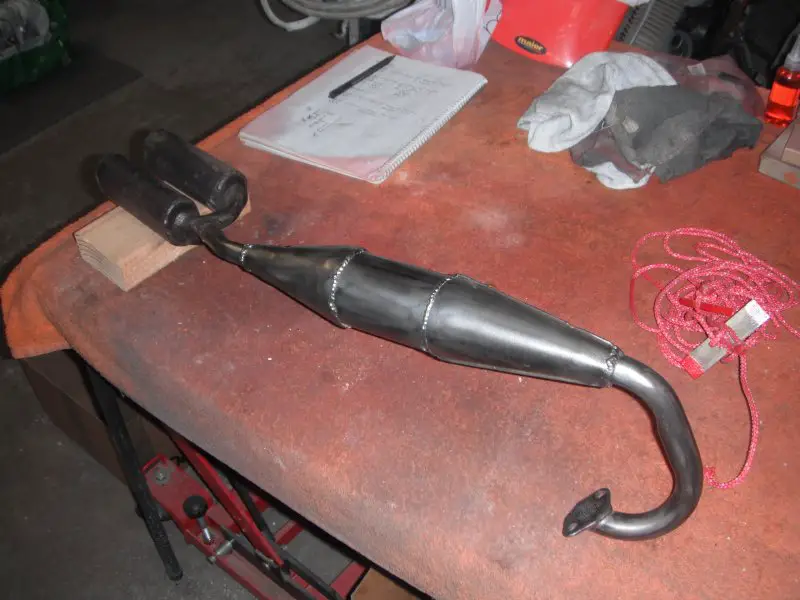

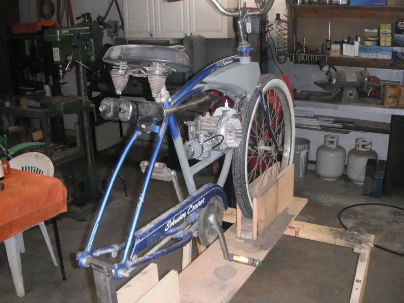

Here's a link to my last race bike... https://motorbicycling.com/threads/newest-venice-race-bike.61100/
It had a FMF ~ CR80 pipe that I cut & reworked to fit the bike.
I later added about 3" to the header to bring the power band down to lower RPMs for the track.
This will give you a idea of what you need if you want to get serious about making more power with a pipe... (anything else is a waste of money.)
Honestly... with all those other cheap pipes, you'd get the exact same power gain if you just used a simple 'straight pipe' instead.
