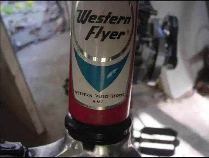

Re: Western flyer Cruiser(aka AMF) (aka Murray)?
WOW whats this, ok what should i call it (Western flyer) Cruiser(aka AMF) (aka Murray)??
ok here is the dope, it's marked Western flyer and AMF on the head tube tag, and has a Murray serial number starts with MOY MO is Murray. it has Murray lines and the Murray drop outs on the rear. correct me if i am wrong.
here is some pics
update it is a Murray early 1965 with a 20/24 code need to find what that is.

My understanding is that Western Flyer was simply the name of the bikes Western Auto retailed. They were actually made by someone else, in this case Murray. Firestone did the same thing, so did speigals, wards, sears, J.C. Penney. Call it what you want. Western Flyer has kind of a fast sound to it.
SB
silverbear you are right bikes were made by different manufacturer under different names ect but.
why dose this Murray frame have a AMF head tube badge mark manufactured by, they were two different bicycle completing manufacture. it is a mystery to me o well.
My 1976 Western Flyer was made by Murray in Tennessee. The manufacturer varied from year to year.
The cool thing is that you have a bike made by American hands with American steel.
I have nothing against the imported bikes. I just enjoy the rarity of an American made bike.

Don P. I was wondering if you could toss me a crumb of information - or anyone else out there who may know - seeing as Don's post regarding my question is from 2010.
Background: In 1972, my folks bought me a brand new Western Flyer muscle bike. That bike came with a front chainring exactly like ones I've seen as original equipment on AMF bikes during the same time period. When I read all the history, I cannot find any definitive reference to Western Flyer(Western Auto) and AMF. I have found references to Western Auto and Columbia Bicycles.
So here's my question. Don P. mentions something in his 2010 post about a Western Flyer Cruiser that he had recently found (at that time in 2010) and that it was made by AMF. How did Don know the bike was made by AMF? Or how can anyone tell? I firmly believe him because of my own experience, but I'm looking for evidence.
Apologies to all - I found the answer to my question as I was looking thru Don's pics. (My Western Flyer doesn't have the "AMF" on the name brand badge - but
it clearly has the AMF chainring) Perhaps mine was one of the first and they were using up all the old stickers.
