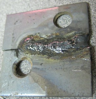

Bought a welder, a Lincoln Century 80. Just a little flux core 115 VAC, 80A unit good for up to 1/8".
Works good, this is my first weld.
