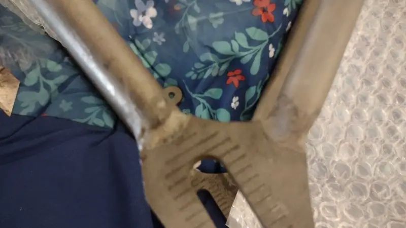

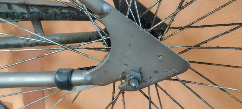

What's confusing me is this stock rear axle nut on an 18 speed Huffy mountain bike, opposite the original chain side.
Typically what I'm familiar with is a square metal piece that acts as a washer, that goes under this nut and has a small lobe sticking out, that tucks into the frame. This keeps the wheel from ever shifting out of place. At least I've seen these on other bikes.
Well look at this. The factory wheel has just a plain nut, no lock washer or anything under it.... and what's worse a long open axle slot that allows the axle to shift all over the place in position. Why would they do this, or such a design even be needed? It makes no sense at all to me.
I'm thinking well, the torque of the motorized bike chain is going to be pulling on this spot big time, so won't that keep knocking it out of alignment? But I hesitate to change things because its what the manufacturer designed/put in.
The nut itself appears to be a bit of a lock nut of sorts. Is this good enough? :confused:

Yes but shouldn't that back bolt have some kind of washer or seat with it? I mean its just open on the frame.
Won't that come loose or get pulled out of place eventually with the chain lugging on it all the time.
Why is the location of the axle adjustible at all? It should only ever be in one spot, with the wheel exactly parallel with the frame. The design has me utterly confused.

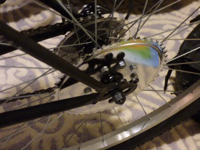

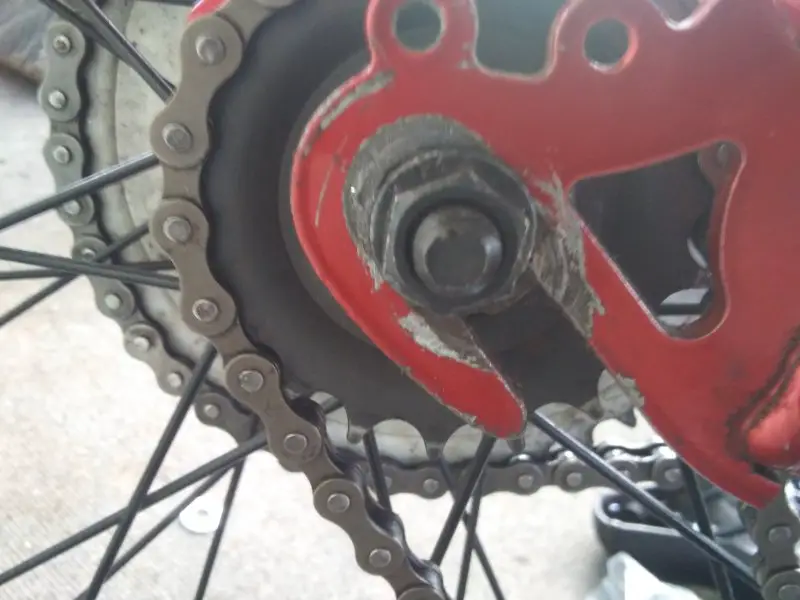

Here's a pic of that guy's bike who posted the thread I linked.
He appears to have the same setup where the bolt is on a long unseated frame "loop"
And by bolt, it looks like over time its been moving around like crazy, with the chain pulling on it.
I don't want that! What a dumb design I guess
