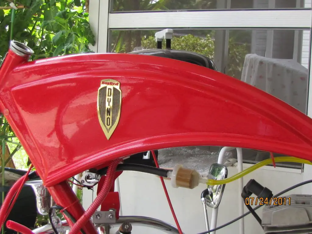

Pat,
How much fuel does that beauty hold ? And I have to say that You are setting a pretty high bar for parts...again beautiful !!
Cheers
Chainmaker,
Thanks for posting the photo fo your bike and tank. It looks really nice and the vent line treatment is super. Once I get done with my current build I want to do a second generation of my tanks with the vented cap kindly shared by ferball which will eliminate the need for a vent line.
