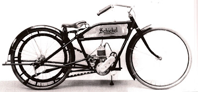

I appreciate your input, but i think ill go ahead with this frame. Heres a few of the "skinnier tyred" bikes i mean. I did see a picture that showed exactly what i meant but cant find em. These will give you some idea....
http://www.nostalgic.net/arc/pre1920/1910's Shaw Motorbike 1.jpg
http://www.carandclassic.co.uk/uploads/cars/triumph/1590326.jpg
http://4.bp.blogspot.com/_lVCC9aDALT4/STMTTBYWMoI/AAAAAAAAFu8/1wR174NG8r0/s400/litewt.jpg
