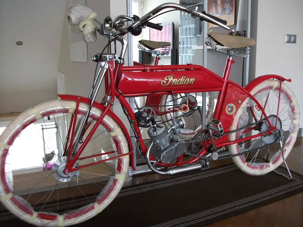

Woow!!! What a fantastic build! It's an awesome craftmanship!!! Did you do that custom frame by yourself? Those are beautiful welded joints! The tank and oilbox is a masterpiece also! After this yaw-dropping work how on earth do you have problems with a frame :)?
My favourites:
- it's wrapped in paper but it must be a beautiful carbide lamp on the handlebar.
- That must be a chrome finished springer fork, I see you sanded and painted its main fork to match the bike
- I guess you use the same twisted horn I do
- Chrome cover kit on the engine
- Copper fuel pipes :) beautitully bent
- Custom spring-loaded chain tensioner
- Custom bent muffler
All in all, a great work!!
Thanks!
The frame was a job from Mariusz. Talked to him before I started the second one. Would not do one again. He said if I order 20, sets up a jig and we go from there. The unit price he was asking, kinda steep!
The tank and oilbox done by someone else. The oilbox was actually a storage compartment.
I could do some of the work, but don't have shop or suitable space.
The new frame gonna be made from 0. No donor frame.
The picture was taken just hours before I took it to Hungexpo. The carbide lamp I bought from Vatera, 1920s. Planned to put LEDs in there just like yours, had no time to do it.
The fork was kind of a mistake that I bought it. It's the Chinese one, available all over the place, for around 60 USD. It was so dangerous, I had to modify and stiffen it. Just an advice to all of you guys: don't buy that fairly good looking, chromed springer fork. As you take it out of the box, IT IS GOOD FOR NOTHING! YOU WILL NOT BE ABLE TO RIDE YOUR BIKE WITH IT! IT WILL KILL YOU! Weak, poorly constructed, once installed wobbles sideways. feels like the fork is made out of chewing gum.
On the new build I'll try to replicate the leaf springer one. Custom made fork, spring, rockers etc. ...and just to be on the safe side, make a HD style springer as well.
The engine lids were just polished and lacquered, no chrome there.
Copper pipes bought at the local hardware shop, bent around 3 pencils.
The chain tensioner and the muffler were modified somewhat, to fit on this bike. Otherwise they were in the kit , that came with the engine.
