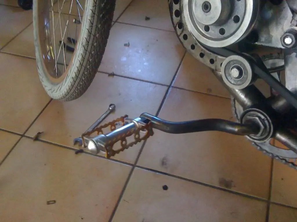

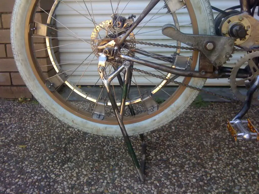

I have a "A" section pulley mounted to the engine that has an "A" section belt and another pulley on the jackshaft. I have a small pulley with a bearing fitted on the end of the clutch lever. It puts tension on the primary belt to get traction to move.
I have another "A" section belt that runs to a 20" bike rim fitted to my rim via brackets to my 26"rim

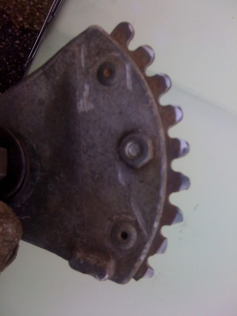

BUT the kickstarter and gear were very old and worn and i needed to repair them by filling them with weld and filing them down....... but when i tried to use it it was jumping gears....... and since its just easier to ride along and bump start it i havent spent the time to get it working properly..... although it would be cool for car shows etc.

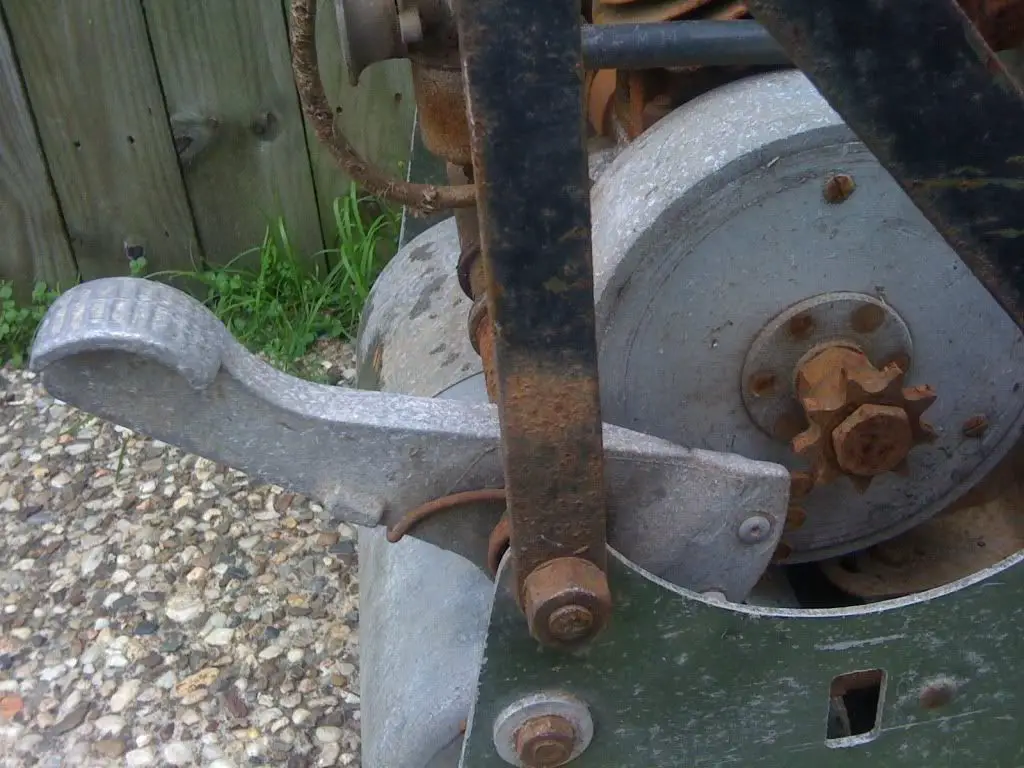

I used the kickstarter off a Villiers cylinder mower, i had a hole machined in the end of the keyway shaft i had made, and welded it to the end. The sprocket has a one way ratcheting thingy
The Villiers mower that had the kickstarter

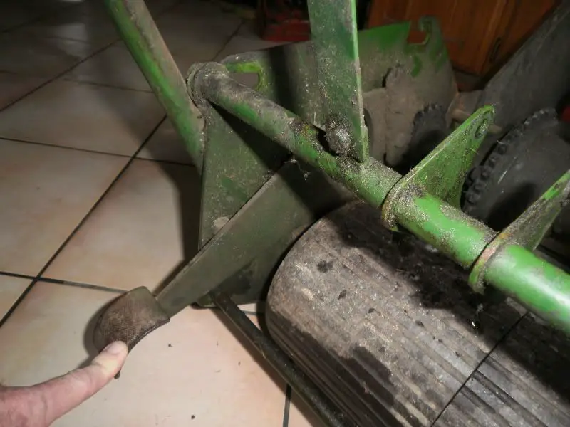

Here is another mower i have but the kickstart is very large and heavy
Here is the worn kickstarter

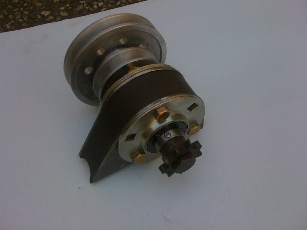

Jackshaft with kickstarter sprocket thingy
The problem i may have preventing it to work is i have it on the jackshaft and not the flywheel like it originally was..... and because of my jackshaft gearing it would be spinning the engine at a different rpm...... if im making sense?
