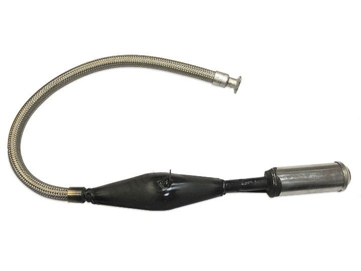

Hi All,
I recently put this on a build that needed the flexibility and since it was not for me I didn't want to go the custom welded route if I could avoid it. Problem is the engine is running like a real dog. No power throughout the RPM band. I don't know if it is the pipe for sure or if I should be checking something else. For me to test another pipe I'd have to fabricate something. Any input from anyone that has tried one would be greatly appreciated. I'd expect at least stock muffler performance but I'm definitely getting less than that.
One thing that I do know for sure is that the opening for the exhaust right at the flange is very small compared to other exhausts. I know this is a sign of restriction but I was hoping to get at least stock muffler performance out of it. It seems that the method of attaching the flexible portion is by crimping it on and I believe this crimp is too restrictive.
Thanks
The header looks extremely long for the expansion chamber. Probably pushing the powerband way low with that length.

the viper and voodoo both got fairly bad reviews, no better (if not worse) than stock.
the speed demon favors the upper end too much to be useful for any real torque gain.
the big bertha is ok, but burns your leg if not heavily wrapped, and is constantly in the way, especially when heavily wrapped...
sbp's "tunable" pipe got the best reviews of all, with aprox a 45% gain in overall torque, and a slight gain on top end speed...

I do believe it is worse than the stock muffler. I don't mind fabricating an exhaust for one of my bikes but this one is a buddies bike and I really don't feel like running around getting stuff welded up for him. I already helped him put the engine Kit on and do a bunch of other stuff. He's going to have to figure it out on his own. It's for one of those Schwinn OCC choppers.
Thanks a lot for the input.

That flex pipe I got is real garbage. Hopefully someone else reads this before buying.
I got one of these from bikeberry and was not happy! the hose inside diam was actually smaller than the stock pipe!. it was ok on bottom end, but once my 49cc engine reached 4000rpm, it killed power and wouldn't rev out near as high.
pure trash for any 49 or 66cc! if I knew of this forum before buying parts i'd've saved lots of money! BB even resells these for about $75. I see them on ebay for 49
