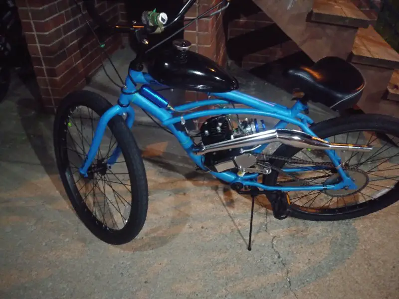

I completely understand!! Main reason for the new hub adapter was for safety reasons! It also made the bike run much smoother! Like I said speed is definitely not my top priority! Honestly I'd say a well running engine that's reliable and obviously id like it to look nice...who wouldn't! Haha! The carb is actually a better version than the stock but till cheap....nightiger or something I think??
Considering this is all new to me I'm happy with it!
