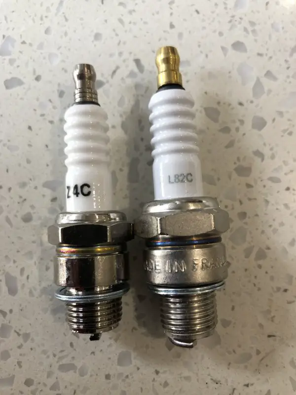

Onto the next problem....I bought what I thought was a Champion equivalent spark plug to the Chinese one supplied but the thread is longer, is this OK, if not what plug do I need? I want to stick to a Champion btw

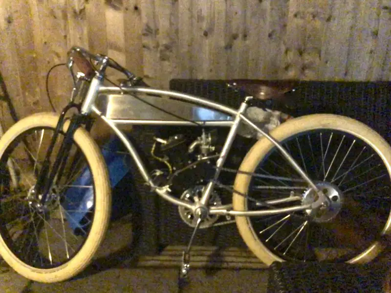

Getting there...laid back seat post manufactured and fitted (excuse the bad picture but it was getting dark). I'm going to cut about an inch off the seat tube on the frame to get the seat position lower. Nearly ready for stripping down and powder coating the frame.
