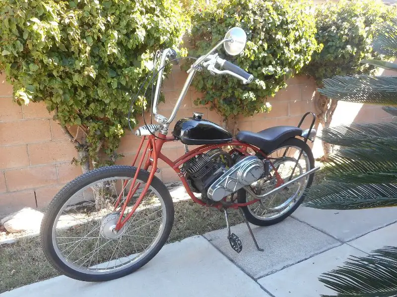

I have a few motorbikes from 3hp to 8hp and found if you build it right they will perform nicely. The main thing is safety. When you start using higher hp engines you need to add gussets at weak points in the frame, heavy duty tires like Maxxis Hookworms for example, strong front and rear brakes with heavy spokes and hubs, solid seat, front suspension forks, better levers than come with kits, good cables cut to the correct length routed well and clamped down to the frame, solid engine and fuel tank mounts, robust throttle return spring, high quality chains, etc. You basically turn it into a light weight motorcycle like they did over a hundred years ago. Luckily we have better roads, modern light weight engines and high quality components so we can go faster safer. It's like building a hot rod car. The more power, the better everything else needs to be. Some builds took me a year to make everything just right and a lot of the fun is in the R&D and making the bike one of a kind.Has anyone tried an engine like this one? It might be a bit too much for a bicycle. I think it was made more for mini-bikes. Just wondering what you MB vets think.
