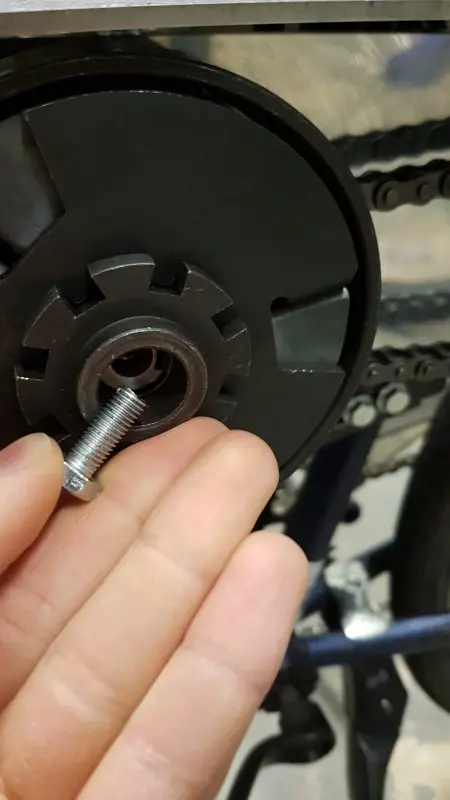

Hi, does anyone know what the thread size is for the shaft bolt on the 78.5cc Predator clone for the Gasbike kit?

Could be a 7mm x 1.25 ?
Why did ya need a new bolt anyways?
Lets see a pic of the head of that 1/4" x 24 bolt
There should be markings on it that will identify if its an American bolt or not

ya some are so close that they will thread in, i would double check, if wrong could easy strip out..................Curt

If it has no markings on the head it's a grade 4 bolt or lower which is weak for what it's being used for

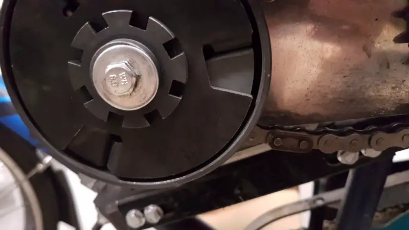

That's a Metric bolt, 8.8 is equal to USA grade 5
Home depot told you that bolt with 8.8 stamped on it was a USA 1/4" x 24 bolt?
I went to home depot, and the bolt fit perfectly into the hole marked 1/4-28. No play, and no unnecessary force needed.

What do ya think grade 8.8 means? Metric Grade strength numbers on a bolt means it's a metric bolt
USA bolts are not stamped with metric grade strength markings
Metric bolts are not stamped with USA grade strength markings
Go back to the store and see how it screws into 7mm
Is 7mm the same as an m7 bolt? I know this question might make me seem a bit thick-headed, but I'm definitely not an expert at bolt sizes

Yes it is though it could have more than one thread pattern.
What thread pattern for an m7 would match up with a 1/4" by 28. The 1/4" by 28 seemed to have matched with the bolt that started this whole conversation, but the fact that you say that 8.8 is a metric bolt grade makes me think otherwise.

It'd be rare that a any standard or metric bolt and/or nut tread pattern would match though the diameter might be close. M8=5/16", M13=1/2", M14=9/16", M19=3/4" etc.
