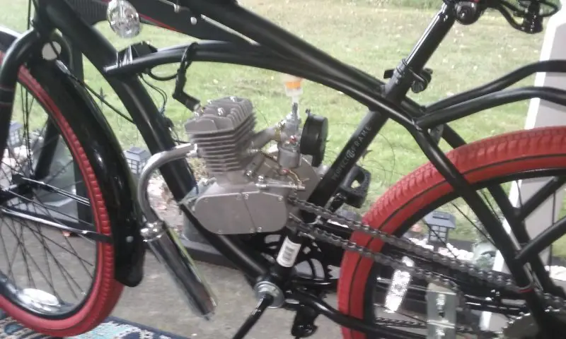

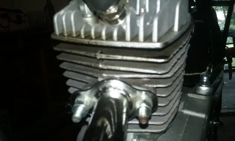

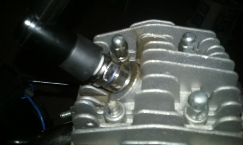

well first i had to return my bike because it was damaged, got new bike was perfect mounted the motor and did the 5 min warm up cooldown and took it for a ride.....started to hear a knocking noice and saw oil coming out the top between the cylinder and the head ....turns out one of those long rods that is screwed in to motor that holds cylinder in place is stripped so that's why its pushing oil out of it its only tight with 3 bolts...

Dang bad luck, you can replace the stud fairly easy if the seller doesn’t make it good.
If you have a tap and die set you can remove the stud and re-thread it with a smaller die till a new stud is delivered.
Now hold on a sec Gil, You are not out of your league, you are on an adventure. You know what you gotta do. Ask yourself -Is there anyone in my immediate world who may have and can help me get this re-tapped? Mech. Friend, reletive, someone @ work? Just another hurdle to jump... You gotta do it though. Greg58 myself and many others will help you along. Consider a new head Gasket. Focus. Keep us posted.
Gill it should be fairly easy to to get the stud out, remove the remaining three nuts, head and gasket. Now use vise grips or pliers to screw the stud out, grip the stud below the thread area. Take it to someone you know that has a shop, any shop that does general repairs can thread it.
