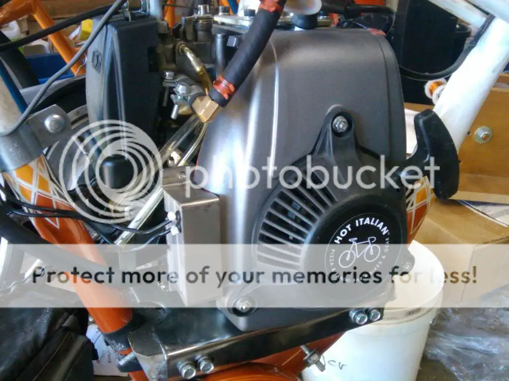

Here's my alternative, puts out 8 watts max and should be very reliable.
