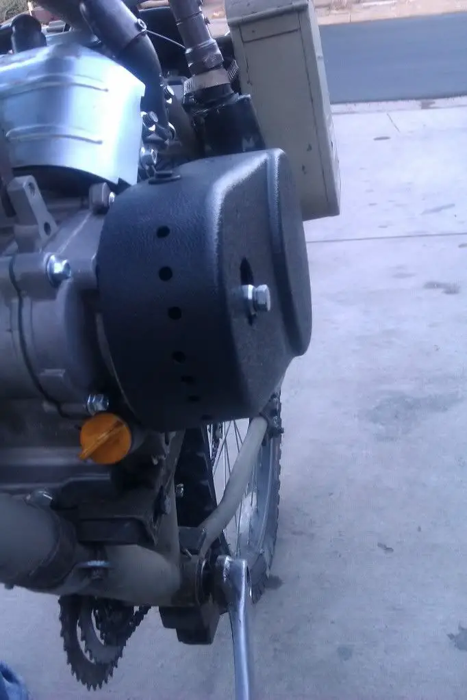

amazed at how hot these transmissions get hopefully some air holes will keep the heat down

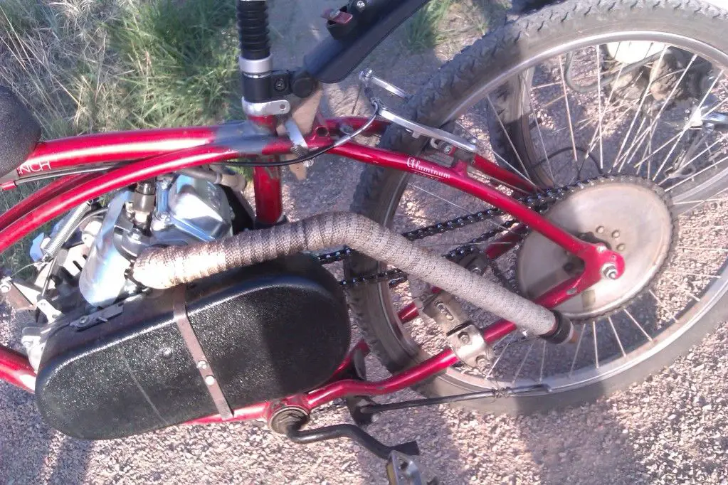

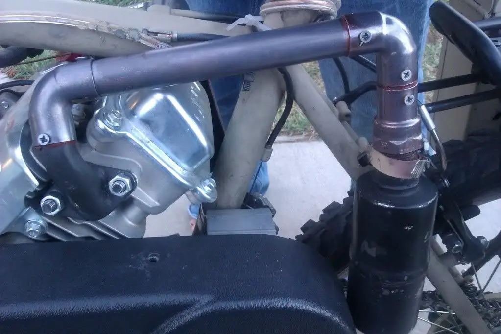

my shiny copper exhaust couldn't stand up to the heat being sent through it i actually like it its a cool looking purple color.
anyone have any ideas on how to fix this need something to cover it my leg sits up against it untill i fell the heat being put off from it . its not dangerous or anything but its quite anoying when i forget to ride bowlegged

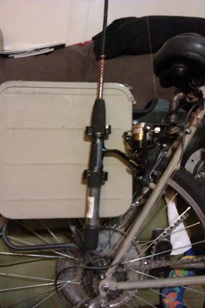

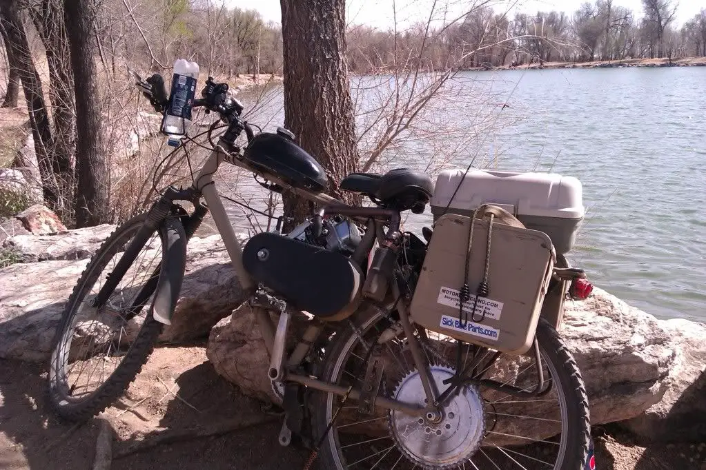

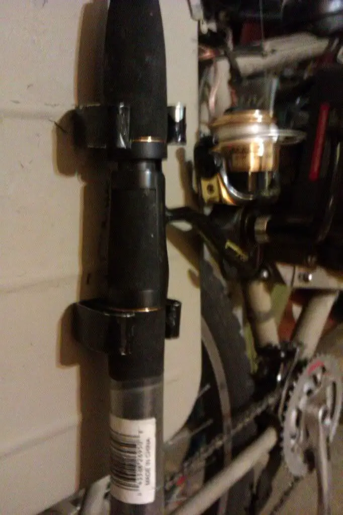

going fishing tommorow thought of this just in time was gona put it in my back pack but this should do and it will double as flashlight mount for a mini led maglight .

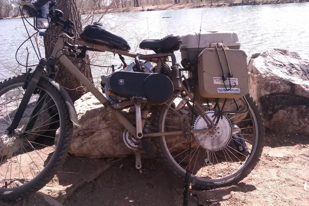

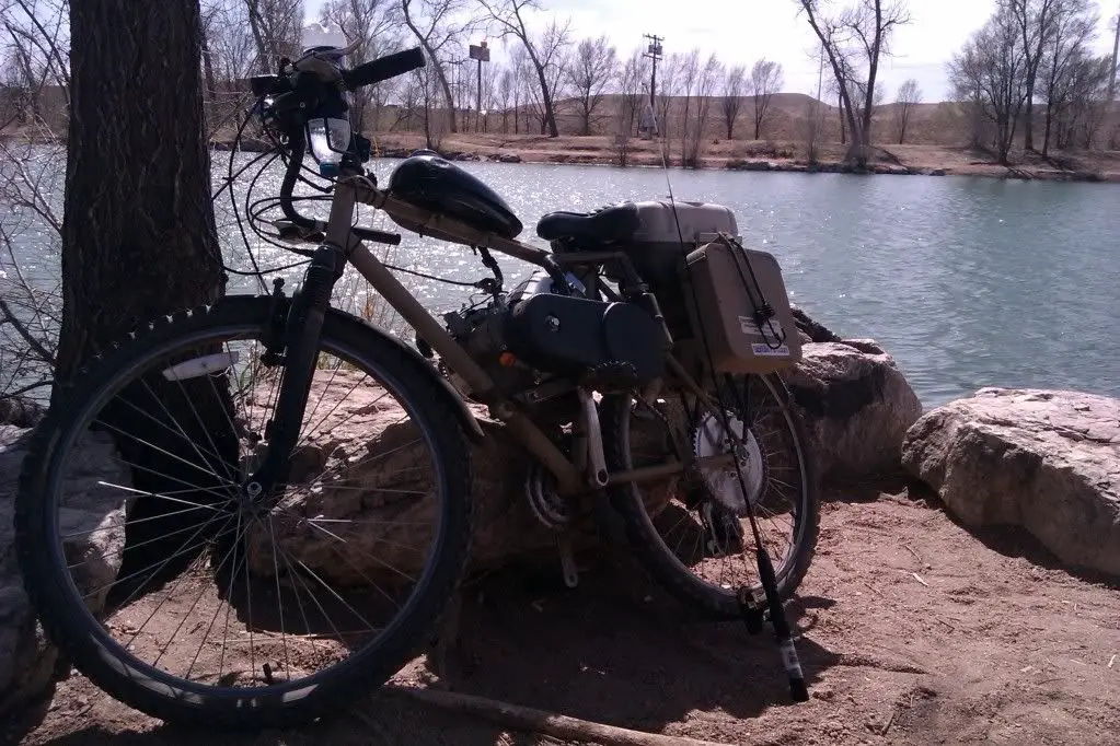

took the infidel on its first official fishing trip good to say that it was a success other than the wind
threw the fish in a bag with a frozen water bottle to get it home that got me thinking maybe a spigot on the bottom of one of the ammo cans wouldn't be a bad idea throw some ice in their and when it melts just open the spigot and let all the water out . just a idea in a endless list of them also mounting takes a little more effort have to lean the bike to one side then throw your leg over .
not a bad day all in all for just hitting up the local fishing hole about 15 miles away .

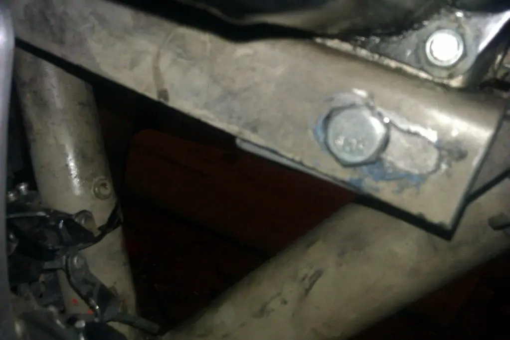

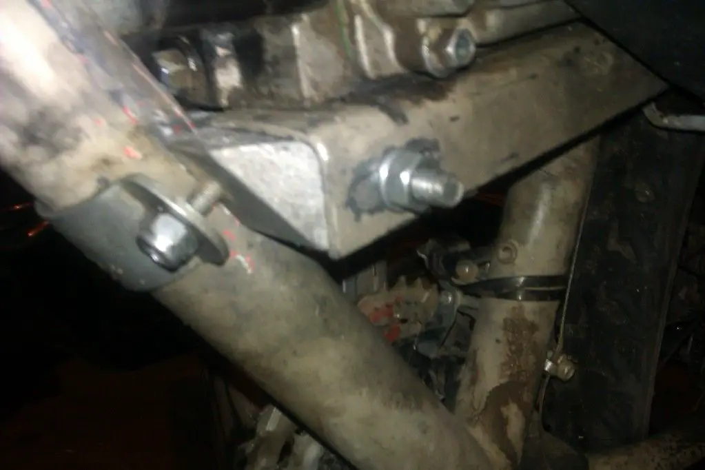

drilled the mount holes were the bolts were all the way through and now the mount is done with one long thick bolt .
all ways saw the mounts a weak point this should make her bullet proof realy sick of losing mount bolts .
[QUOTE
QUOTE]
**** yea it's dangerous! That pipe gets to about 900-1000 degrees f. that close to the head.
I used a split piece of 2" aluminum tubing mounted to the pipe with 2 conduit wall mount clamps.
love the idea for the exhaust

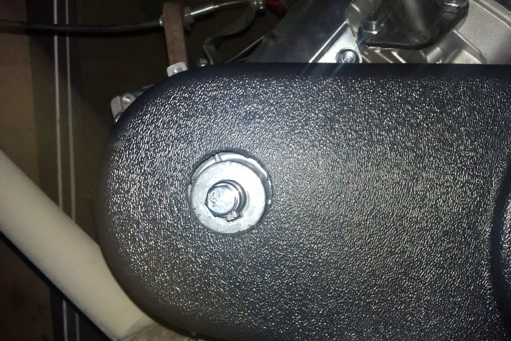

its the bolt from the transmission sticking out that drives me crazy got a few tricks up my sleeve friend gave me pedal extender and going to re do my pipe and attempt something similar to yours .
i know to much about burns lit myself on fire a year ago dumbest thing ever bottle of heet into a open flame equal burnt Andrew s 2nd degree to over 10 percent doh bag balm works the best .
does the shield take a lot of the heat off or just give you more of a warning .
The shield is about 1/2" away from the pipe. It gets just hot enough to be uncomfortable with your pants leg hard against it but not hot enough to burn you.
Could be cooler with plenty holes maybe. But it's not hard at all to live with and quite safe like it is.
