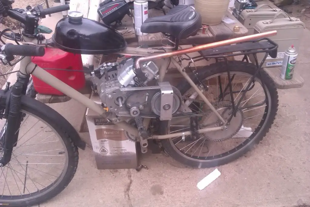

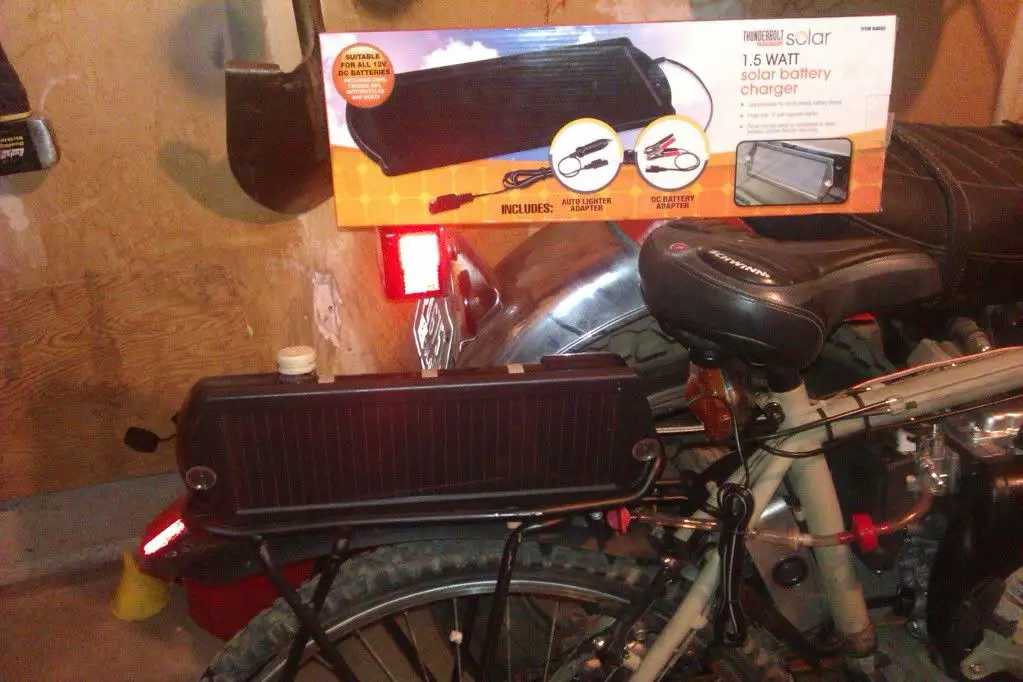

saw this today gave me a idea its a 1.5 watt solar panel .
i have a motorycyle battery i use to power my headlight and was thinking on overnight trips i could use this keep it juiced up i plan to stop at night so it will not be useing it for that but will use the battery to charge my cell phone and ZUNE.i know its not alot of juice but should put out enough for my modest use of it .
its almost the same exact length as my rear rack and cost me ten bucks at harbor freight.

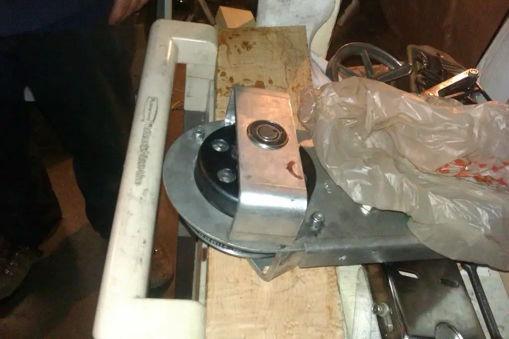

drilled a small hole then tapped it so i could put a bolt in it and hopefully avoid my idler pulley falling over into my spokes .

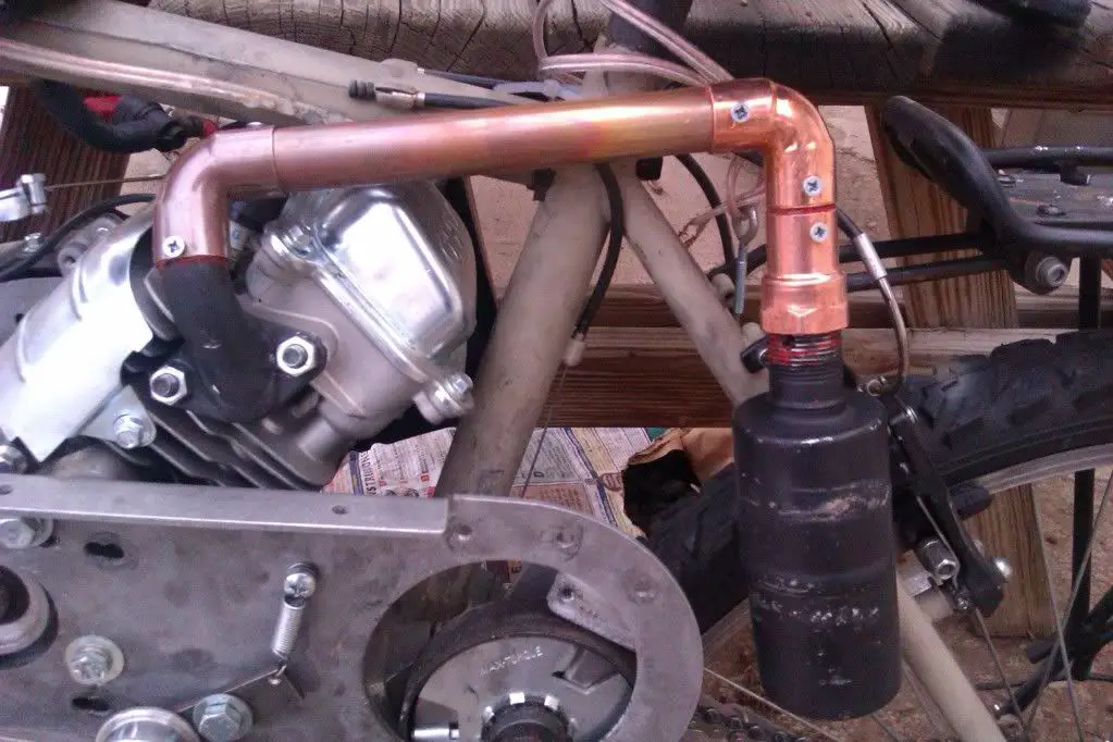

(had to ditch the muffler it suddenly dawned on me that i couldn't pull the trailer with it on noise level realtivly the same )

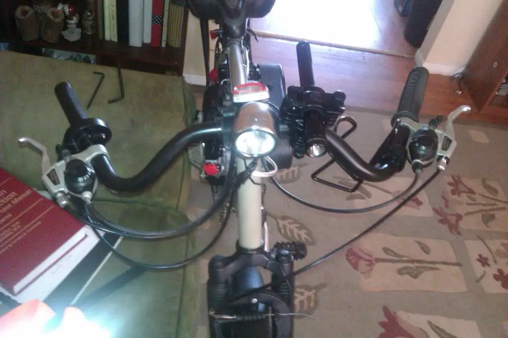

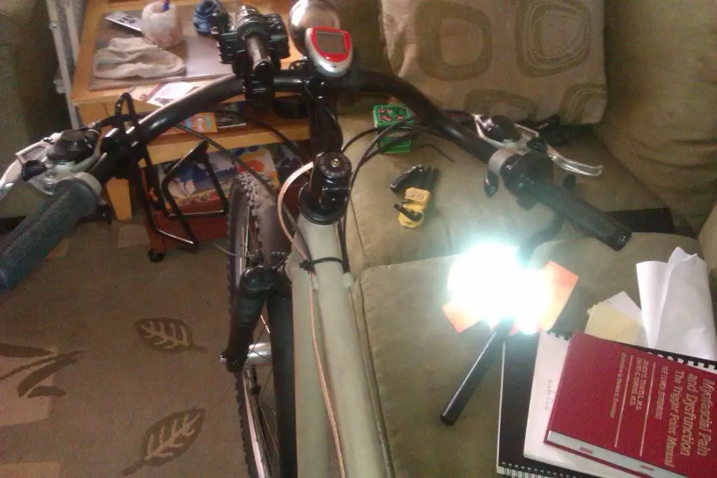

the new handlebars should help me keep up with you this year on the trails frank . they are fairly comfortable to ride with to .
( i know they wont help me go any faster i do like the look more though)

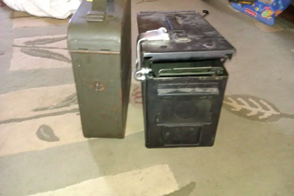

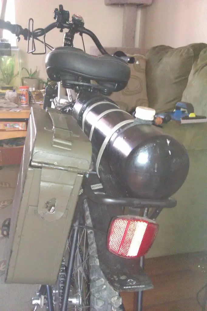

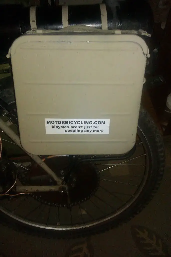

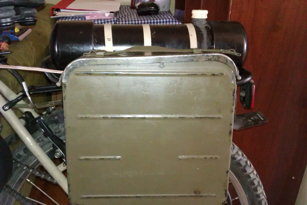

went looking for some ammo cans like ive been meaning to do since i started this build the us 7.62 cans were fairly rusted i found these for only 7 bucks at the local surplus i think thier polish or possibly chinesse realy like the lines on them and they fit the bike better than i could have ever imagined just gota work on putting a lock on them .
their not as water tight as a american can with the rubber seal the metal is roughly the same thickness though .
paint ideas
tan
black
tan with a black star on it
keep the faded od green
have to leave room for the motorbicycling.com sticker
hmmmmmmm.....................

How much does the solar panel weigh? You can get cell phone chargers for your bike. They're very light and can be used to charge other things.
Panel weighs about as much as a full Pepsi can I've been looking at the smaller ones for local trips and just mount them onto the handlebar so I can juice my gizmos while I ride the big ones are more for trips when I have the trailer
Considering putting a car battery mounted in a ammo can juiced by the solar panels just ideas
Does your solar panel have a built-in charging regulator? If it is just a solar array you will need to add some sort of charging regulator to your solar panel circuit. The output power of your solar panel and the current draw of your equipment will help you decide what size of charging regulator you will need. I build 12v and 24v solar sites in the mountains. I use ASC type-F pulse charging regulators. They work well.

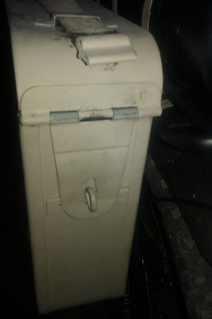

painted and showing off my sticker.
added some eye bolts to put locks through think they should work just fine had to grind off the old locking mechanism and drill a hole in it fit the locks i use just fine.
the panel is supposed to have a built in regulator so far so good gives it enough juice to charge my old Zune and phone .

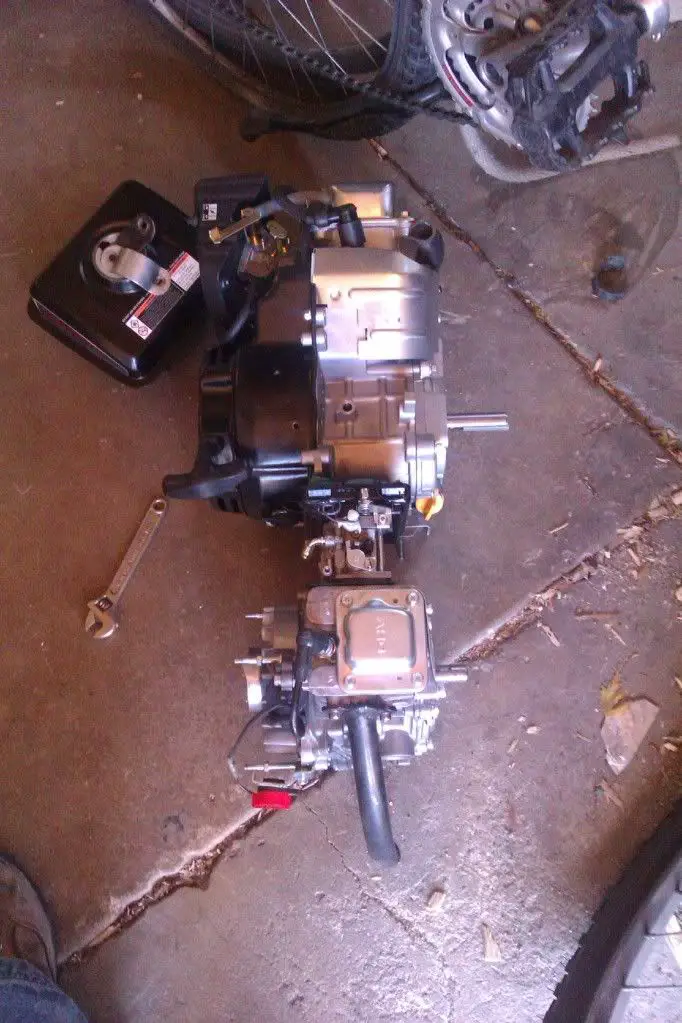

today me and local MB rider Shawn went to harbor freight i was able to get my 99cc engine for 87.99 thanks to a 20 percent off coupon in the back of the popular mechanics its in their every month well worth it . any way we got the last two engines only one left is the display ive got mine gutted of useless stuff including the governor and will be doing or throttles hook ups tomorrow . if all goes well should be running this weekend on sunday wish us luck .
Sounds interesting. I want to see how the project turns out and how well your 99cc does. I was thinking about getting a predator 99cc and doing the swap, but at this point IDK, I want to see what the 49cc can do all race modified. Keep us updated, and get that bike running. We should try to get a ride in sometime... :)

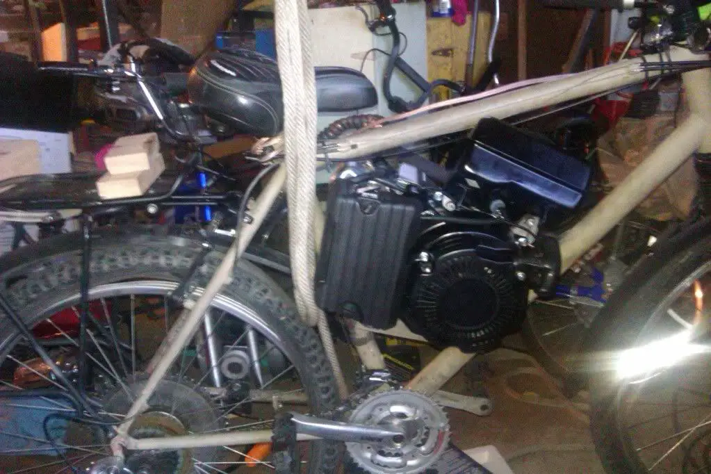

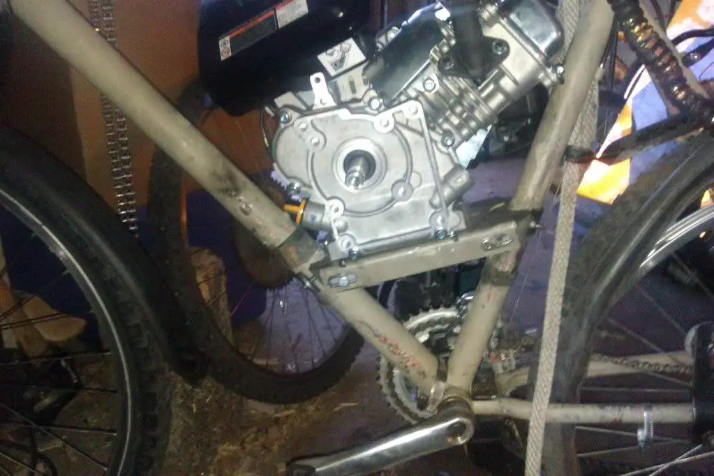

turned it on today after getting it fit in the frame very snug in their looks good though should have pics up in a bit really need a muffler set up for this thing sounds amazing though .
so far just waiting on the new belt and pulley .
everything else is all done on the bike .
stock gas tank on just for starting up purposes
people that have a qmatic can see how i had to switch it up just a little for clearance purposes
i just like the side buy side of the 49cc vs the 99cc

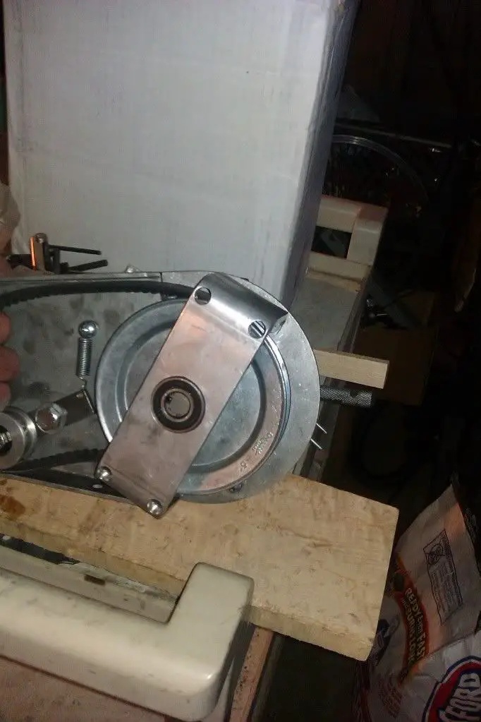

got the right sized belt but my pulley is the right size for something with a half inch shaft laff dont even know how i did that but here i am with a new paper weight
grangier isn't open until Monday looks like ill be kicking myself in the butt for two days the closet store that has it is Denver so looks like a road trip is in order . (not that bad go see some family hit the good trails in Denver )
gives me a little bit to re do some odds and ends at least
hopefully soon waiting on the right pulley to come in might be awhile till i can get it to denver the headgasket blew on my toyota so ive gota get that fixed first
