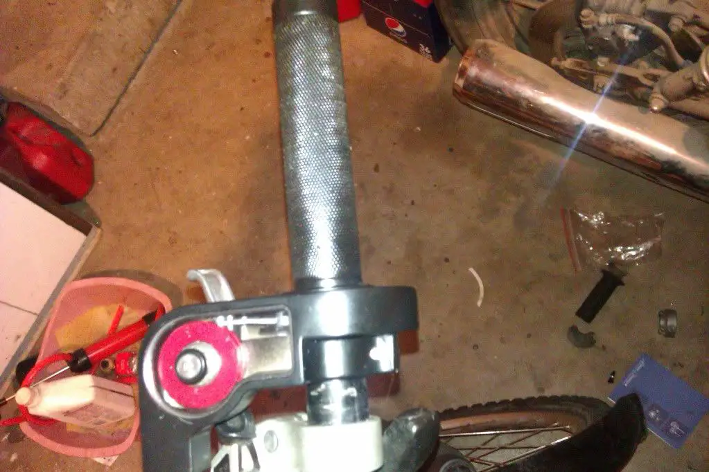

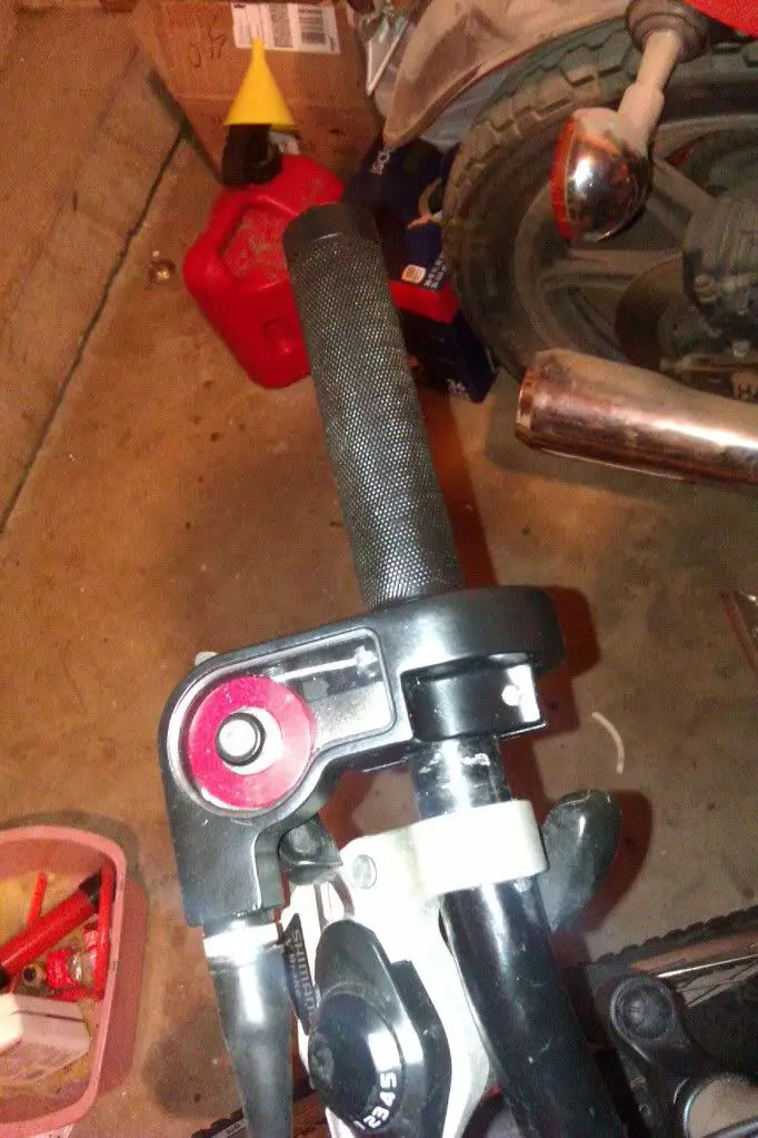

new throttle today from SBP just came in (the NT one in case your wandering which will work on a thumper) this is one is nice and thick and a well built throttle well worth the twenty bucks the action is fast to snaps right back .

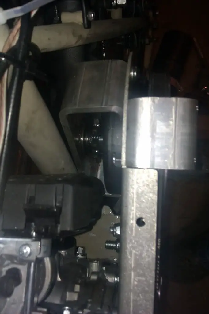

still working on my clearance issue hopefully new shaft helps it just waiting on mail man

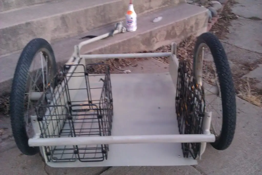

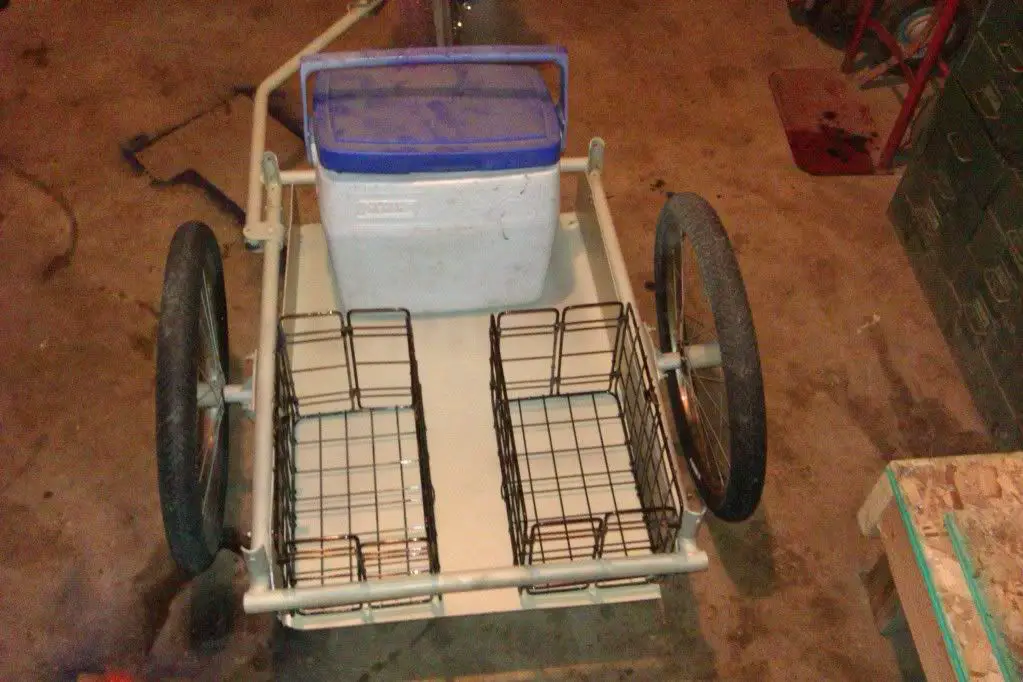

so far only into this thing 75 bucks not bad should haul plenty of cargo around for some realy long trips i want to use it mainly for fishing bolt my ammo cans in with plenty of room for rods and a ice chest . should also be able to pull double duty as a grocery getter .

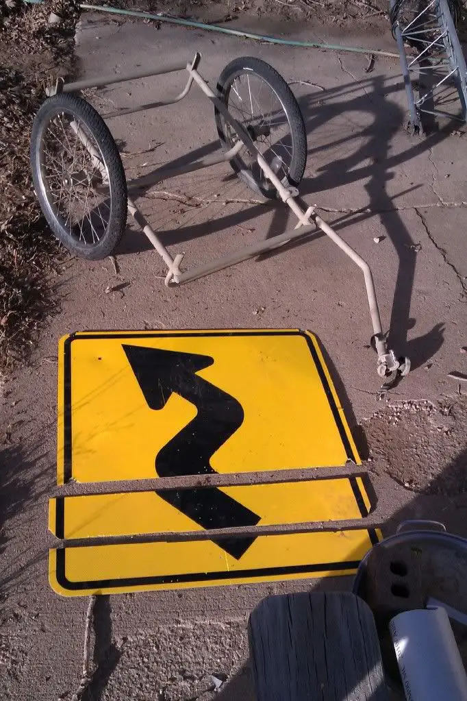

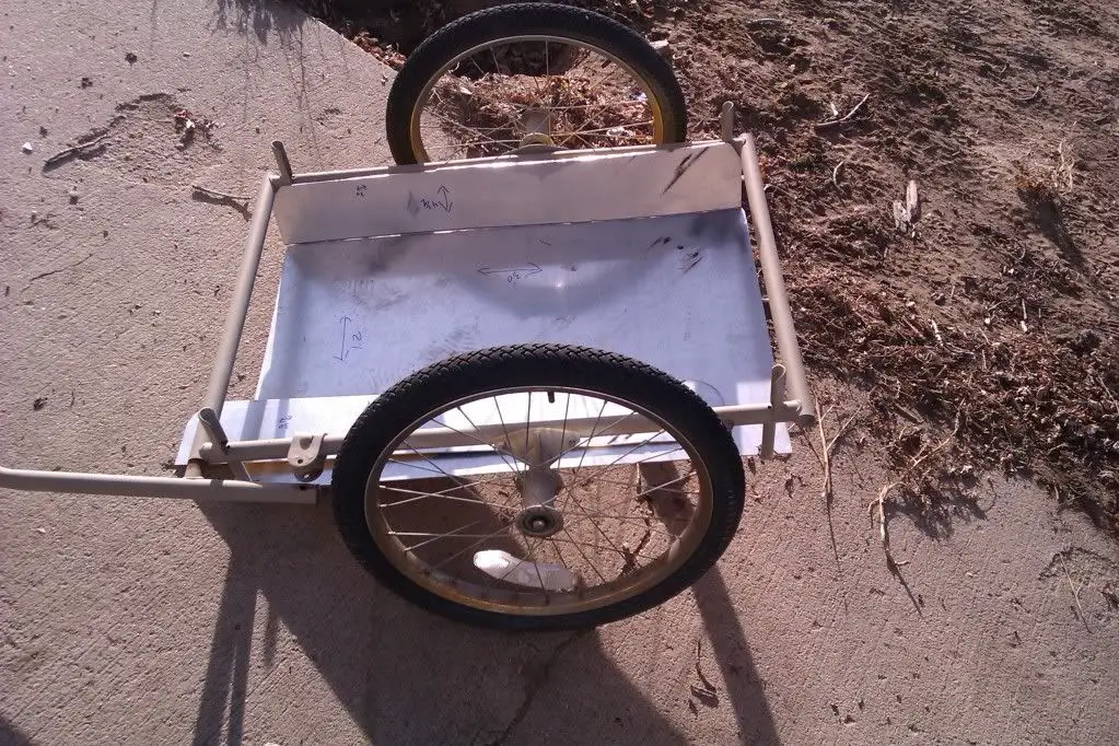

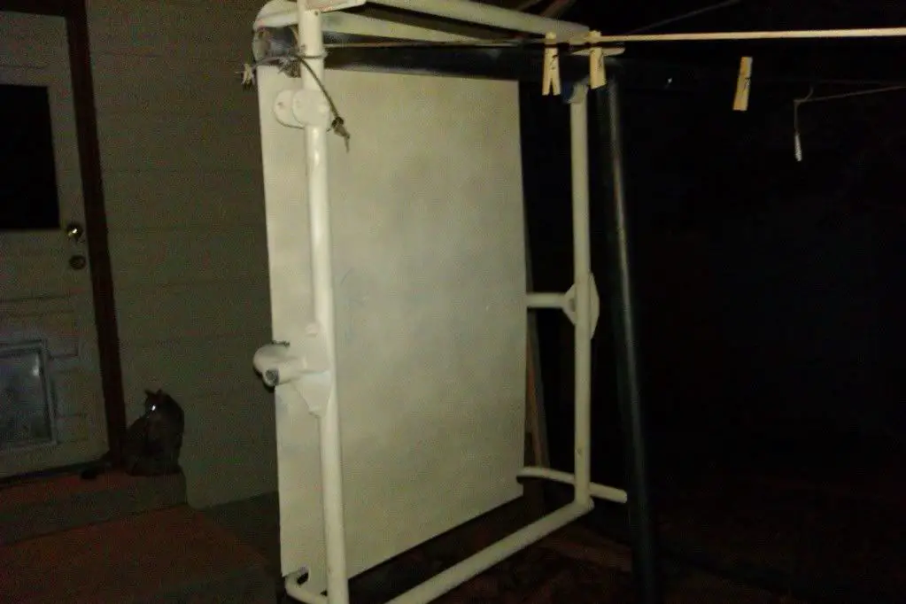

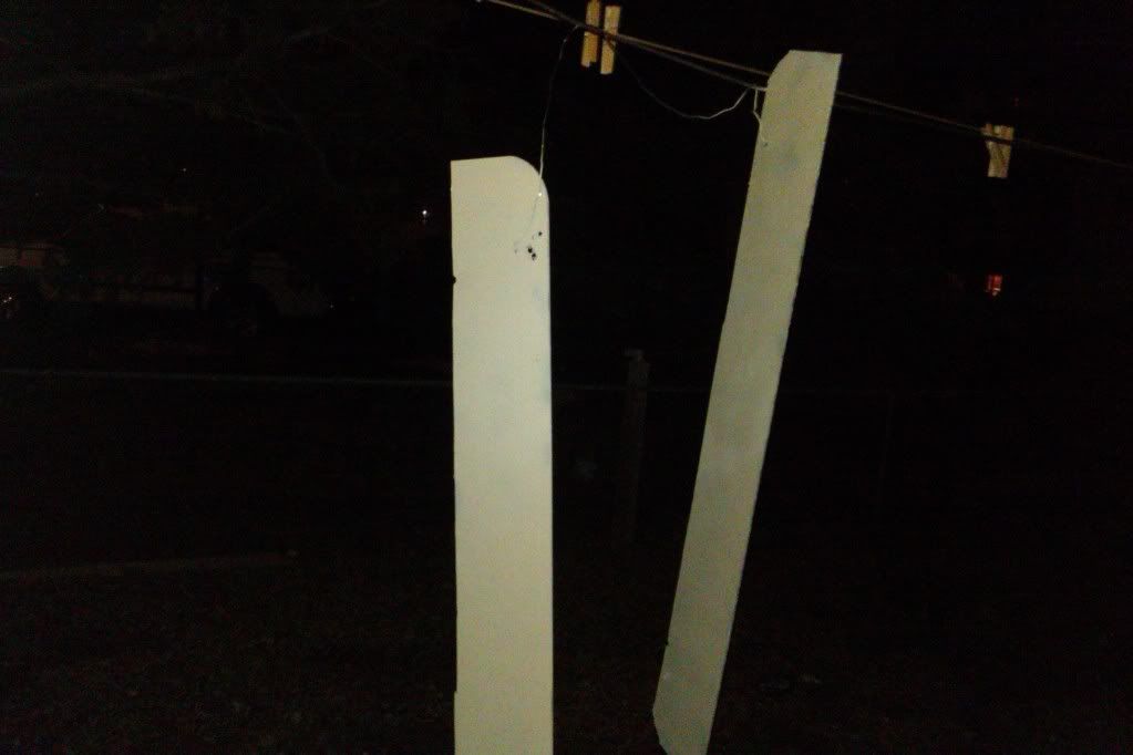

had some good weather today so went to the local home depot and was going to only see what i could see and use for the trailer then vola saw this sign dimensions of it were perfect 30X30 trailer is 21X30 so that left me room to make sides with .
painted it tan to match the bike trying to think of things to paint on it maybe a star or two white or black idk sugestions welcome .will be putting my motorbicycling.com stickers on it thats a definite.
maybe some sort of reflector on the back to help me not get ran over .
this aluminum is nice and thick and rust proof what else is nice is that its easy to cut with a very fine saw blade for a circular saw just go nice and slow with the cutting.

included a pic with the ice chest just for you tom iam defiantly okay with hauling beverages and gear around .

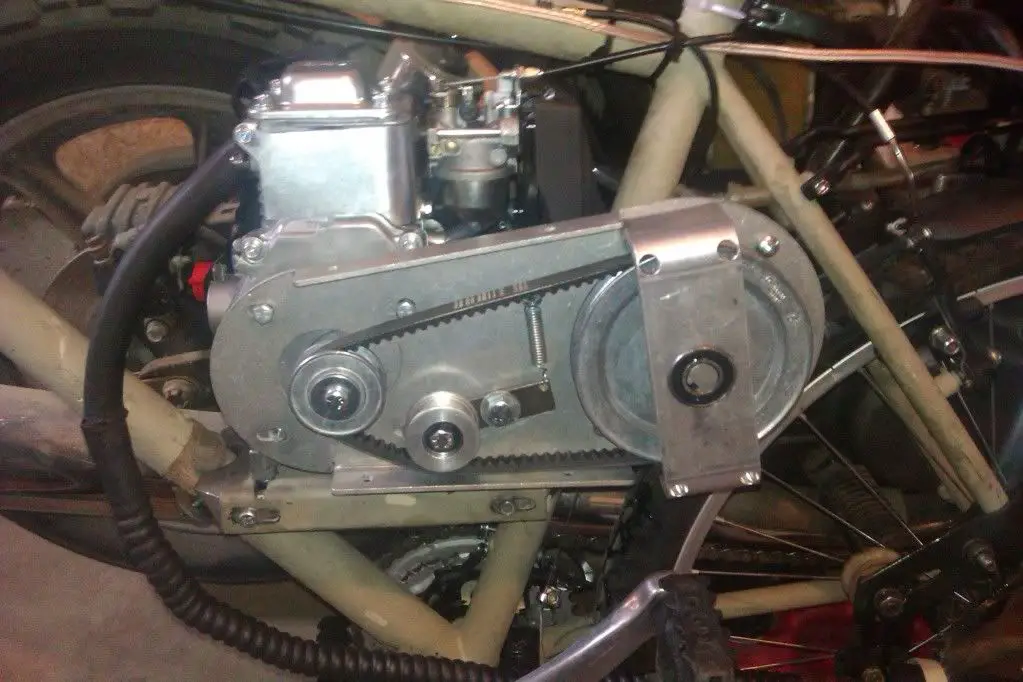

ezm came yesterday sean the local ezm dealer was kind enough to bring it by the house for me.
just had to re tap two of the holes i striped out on my engine my fault not the ezm

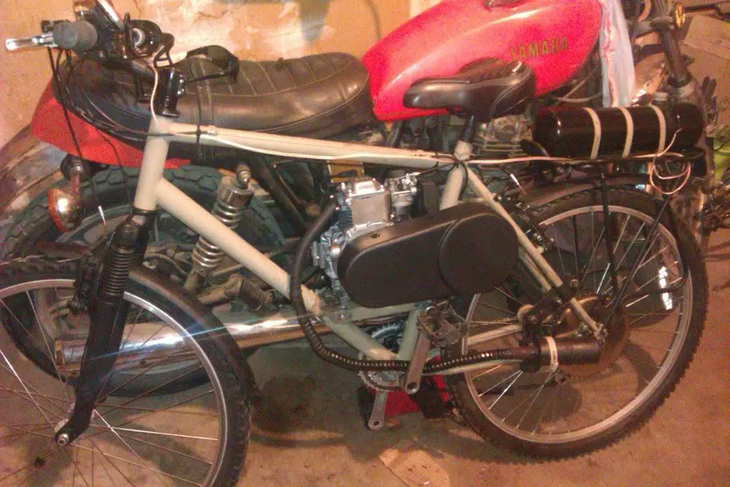

the new transmisson is super lightweight very strong . with the cover on i took it around the block just pedaling (still waiting on my chain ) my pedals clear the engine just fine may get a extender to kick them out just so . but for know they work great .
im going to try it with a 50 th first then work my way up to the 56 th i know they come standard with the 56th just looking for a little comparison . this is so i can see the difrence and see what size sprocket adatptor i will get for the rear . probably this wensday i will put up a video if all goes well

Your gonna want to use at least the 56T. The gearbox is set up to use the 56T. Anything lower there will be way to much clutch slippage which could lead to problems you may not want. A 60T will help the engine pick up faster without sacrificing much if anything on the top end. The EZM gearing is a lot different then that of the 4G or other gearboxes.
What are you going for: top speed, acceleration, pulling power & hills, all around, ???

Just pm me ill give u my adress so for top speed hopeing on 35 cruiseing15 to 20 aceleration not to concerned just hills with the trailer r my only fear
