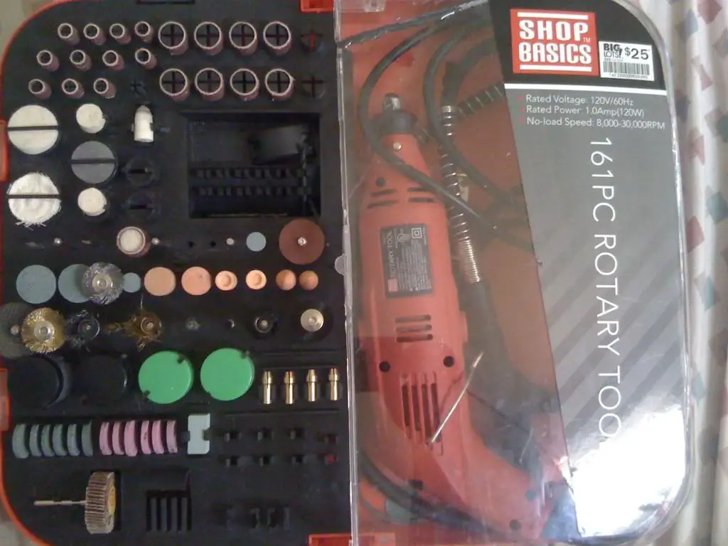

Here is my cheapo dremel kit,$25 bucks. The green and orange are grinding stones for metals and plastics. The brown have more sand grit to them and they will grind metal and wood. Plastics you should cut at lower rpm cause you can melt the plastic ruining the bit. It so has stuff to polish bit I do not know lot about that.
